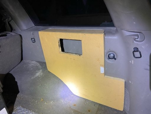

Where did I put it all, great question. Here are some pics, happy to go into more detail if there is interest.
I started by removing the C02 Tank (still need to find its new home) and in its place I built out of the MDF I prev mentioned I created a spot to locate most of the electrical in the original CD changer location.

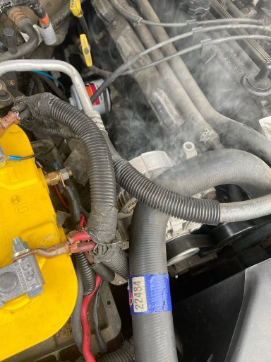

I drilled the hole in the passenger side firewall for the stereo amp and ran it down the passenger side. I bought a T splitter for the power to the Dc-DC power converter. Happy to snap pic of wiring but it’s nothing fancy. Haha

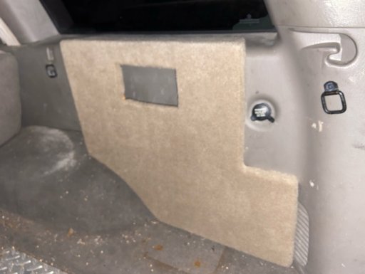

With some time on my hands I'll update the rear cargo space updates that I have been working on.
Last time I showed you the first part I worked on which was a place to land all the elctrical, I then started working on the framing for the drawer in the cargo area. I built the sides and lower bracing with 3/4" MDF I had in the garage and topped it with some 1/2" to keep weight down the intent to update it in phases. I started with a box type frame, carpeted it in the closest to my interior and D hooks to be able to tie down gear and or my spare tire when I go on longer trips. I put 4 spring loaded D rings, one in each corner and a larger one in center for the spare tire. I added an eye ring bolt on the under side so I would be able to strap it down and attach it to the hook on the floor further securing it to the rig. I stole the idea from aftermarket Yoda drawer systems to put D rings on the 4 sides and using adjustable double sided hooks to hold the whole thing down.
I then added the DC - AC converter and have since used it to run drills to install the rear quarter panel protection.

You can see in the above pic here where the fiberglass box is not matching. It was bothering me so in the below I have finished carpeting of the box and then I pulled the fiberglassed sub box and redid it to match with the left over carpet I had.

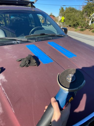

Hey all, been a while since I’ve posted. I’ve been crazy busy moving my family across the state. Before I moved I cut the hood and installed some GenRight hood louvers and had the hood painted. I also ordered some IRO springs and their new heim draglink. I haven’t had a chance to pull the OTK RHD Canada DL since I’ve had some overheating and charging issues.
