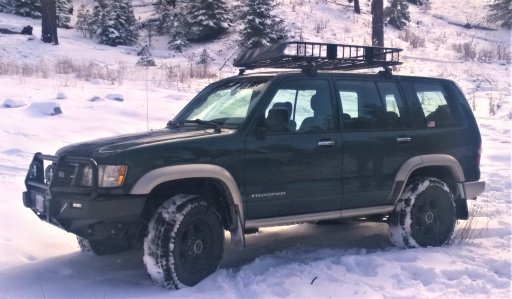

472HemiGTX
Congrats and welcome. Those are great rigs. Pretty bullet proof and easy to work on. My son has a '98 that he has been working on. Good luck with the build.

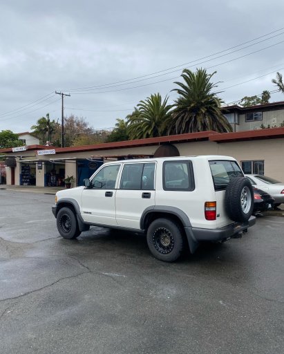

So 1st things first, I got a sweeeeet deal on some rims and tires. They are Method Wheels. (not sure the specifics) they look good on the trooper and fill up some of wheel well space. 71C5DAD8-E0FE-40C7-977A-16691A540467.jpg
I still need to replace the spare, but for $200 I couldn’t pass it up.

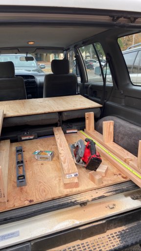

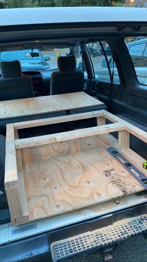

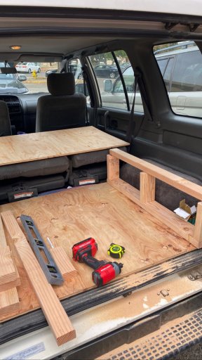

Next, I made a sleeping platform! Lots of YouTube videos and other inspirations and I cake up with my simple build.
The criteria:
wanted to still have functionality of the back seats.
wanted it to be one piece for easy removal (just in case)
and I wanted it pretty inexpensive.
Not to much to ask for. So here’s some progress pics
(Will be adding a small 2x4 to the middle for extra support)

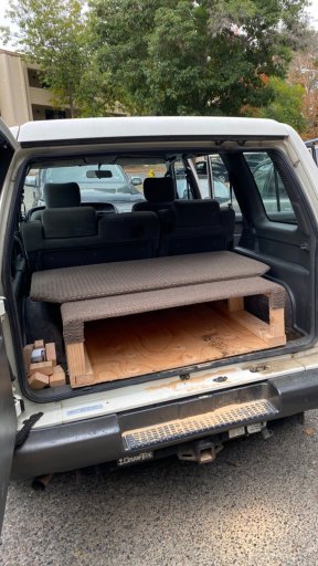

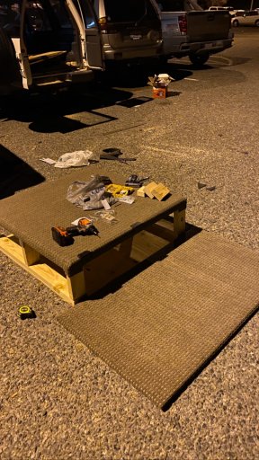

Threw on some cheap carpet that was 50% off!
All together, with hinges attached. And...

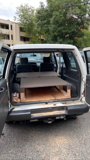

Full functionality of back seats! Yay!
Has enough room to lay myself and my girlfriend back there. Someone about 6’4 can fit back there comfortably! Has some room for side storage, and for the meantime lots of room underneath.
Future plans on building some drawers are coming!
