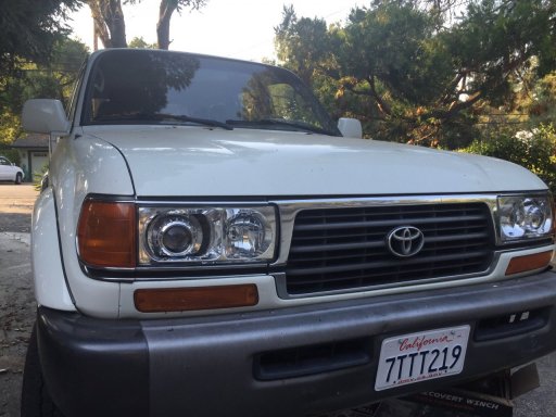

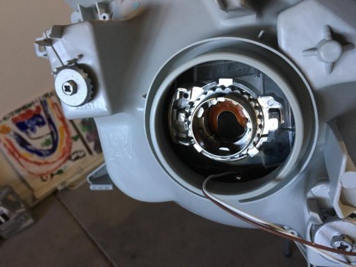

Anyone who knows anything about lighting will tell you not to put hid bulbs in a reflector housing. When I bought my 80 the previous owner had installed a cheap hid kid, just the bulbs and ballasts into the factory houisngs. Shortly after owning it one ballast went out so I swapped regular halogens back in. The difference in drivability wasn't huge but it cut down on glare a lot.
I've since done a d2s bixenon retrofit into depo's and they're amazing, it's like driving with suns attached to the bumper. I'd seriously consider saving up to do it right, that and it will give you 4x high beams so aux lights are no longer necessary.. the savings there may factor in.

Dug up some old photos from my retrofit, now I want to go drive the cruiser haha. To the OP, I'll reiterate my recommendation to not waste money on HID bulbs in your factory housings, if you're going to do it save up for a proper retrofit, either DIY or hire a pro. It's a hands-on mod so if you can find someone who offers the service it may be worth it. There's quite a bit on 'mud about this.
That looks damn crisp sparky! Yes you are right. Buying cheap knockoffs from eBay will make it a bad experience usually. I planned mine out and did lots of homework before jumping in. Does take some getting use to driving with razor sharp cutoffs though. I’m happy with the increased coverage and denser light pattern
