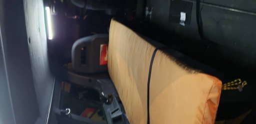

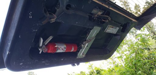

So in 2017 I bought this 1993 ford aerostar xlt e4x4 for the Gambler 500 off-road rally. I am just getting into the overlanding scene as a hobby because from what I have discovered through many hours of research is overlanding is awesome and a great adventure. Currently I am converting it from passenger van to a camper van for woodland excursions. I have framed in a single bed with under storage for my gear totes, multiple fire extinguishers, led internal and external lighting. Plenty of water storage, recovery gear. I have built a spare tire carrier for the rear tow receiver as I had one located underneath in the original location and blew it out going over a downed tree haha. Spare fuel storage cooking gear and propane. I will be installing a roof rack later on. I have installed wheel spacers and oversized 235/75r15s. This weekend hopefully I will be installing a 2 inch coil spacer lift all around for a little extra ground clearance as getting high centered is really my only issue for most offroading I do. Does anyone have any suggestions on what gear I may need that I don't have currently or any build ideas to make this thing more live in friendly. Oh and I have manual maps, compass, and a cb radio for emergency communications. Thanks for the input guys. This is my first attempt at getting into the overlanding lifestyle but I've always wanted to do it. Any criticism is welcomed.20190424_124813.jpeg20190508_091727.jpeg20190427_184845.jpeg20190427_184851.jpeg20180623_151104.jpeg20180623_170609.jpeg20180621_182106.jpeg20190511_210940.jpeg20190511_210914.jpeg20190511_210948.jpeg20190511_210945.jpeg20190508_134129.jpeg20190513_212038.jpeg20190511_210904.jpeg20190513_212050.jpeg20190508_145414.jpeg20190511_210912.jpeg
