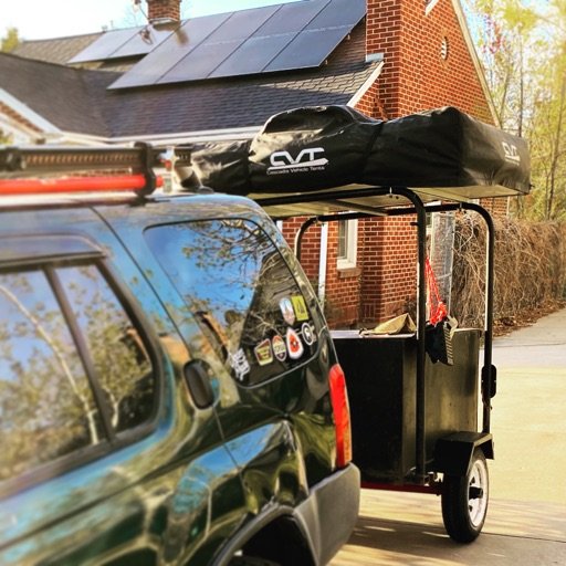

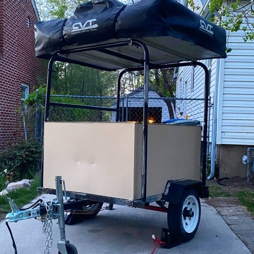

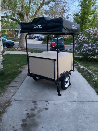

Before investing too much, check the trailer load rating, it looks pretty light.
And add up the stuff you want to load.
I'm thinking that trailer might be easy to overload.
You overload an overland trailer and something will break.
