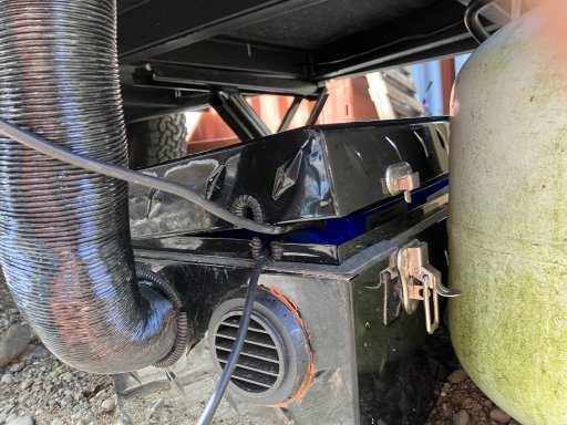

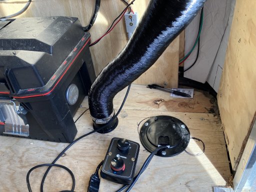

Yesterday's progress is that I have electricity in, a couple of USB ports, light, wired to the fridge and got heat in. I have a propex heater in a craftsman tool box that I uIMG_1449.jpgse for heat.

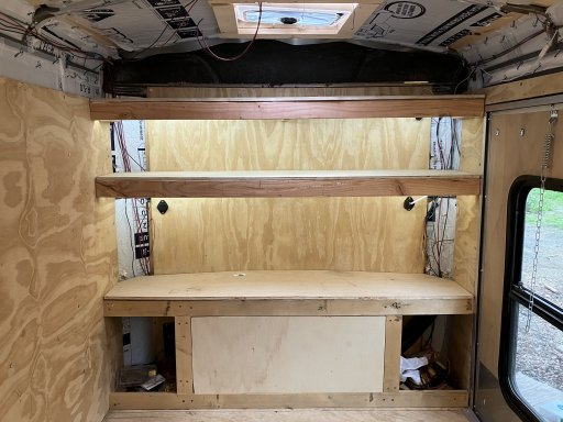

Roughed in the front shelves. More goodies on the way like a Maxfan and got my sliders for the fridge slide. Going to focus on the sleeping area first and then move back to the galley. Primer is going on the walls and floor today. Hopefully color on the walls (two side walls) before the week is up. Next stop will be flooring and max fan then the ceiling in the sleeping are can get done. Step by step!
