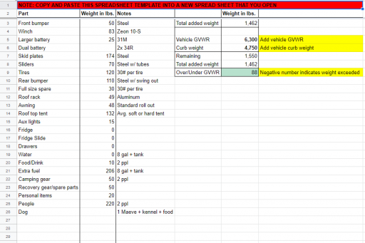

Thank you very much for your information and I really appreciate it. From my time here looking at the forms and what some people are running direct i'm thinking about going with the icon suspension system. They also offer a heavy spring and luckily I found a spreadsheet Excel that gives a rough idea of what to expect. What are sliding so as I add or subtract the overall payload weight will change. Being that I have 1550 to play with in terms of payload it's going to be pretty tight. Also I'm trying to avoid spacers which can be a hassle to weight balance the vehicle with and it changed the Dynamics of the suspension and the ride height that doesn't always be conducive to a nice ride.
I will attach a photo and was wondering if I'm in the ballpark on it.
Reactions: WrightRunner
Nice spread sheet. You want to be scared? Add in a column with cost. I refuse to do that.
If you have specific manufactures in mind and you got the weight from them, I would say "not bad". If you were guessing then let me add in my guess's.
Frt Bumper: 100-200 depending on manufacture. The Aluminum ones are about 75. Some of the bumpers I've seen are way too heavy and comprised of 3/8 steel for some reason. I've built a few lighter bumpers for Cruisers and those are about 100 + winch.
Skid's: You have 174 for skids. Im thinking 50 lb max. On my TJ I had two separate skids of 1/4 plate that gave me coverage from oil pan to back of transfer case. Im guessing those were about 150lb. Do these only if the terrain calls for it. Otherwise just upgrade what you have with aluminum.
Sliders: 70. The ones on my Cruiser are that each side and I didn't get the real heavy ones. If your going to use them as steps and not protection then go as light as possible.
Tires: 30 (ea). Depending on tire/ rim combo and size I would guess your stock ones are slightly more then that. My TJ with 37 mud grapplers on heavy aluminum rims were almost 100 each, my cruiser with 35's and light tires and rims are about 70 each.
Rear Bumper 110: about that + swing out, tire/rim, small rack and fuel/water cans.
The question is, how hard core do you want to go and where? Also the RTT discussion runs like discussing politics. I've been using mine for 7 years. They work.
Three points everyone will agree on are regarding RTT's , make your vehicle slightly top heavy, drop mileage due to drag and noisy if its real windy. I've been in 50 mph winds in mine, held up well, didn't sleep. Would have been the same in a ground tent. My areas are windy about 50% of the time. For that reason only is why I'm moving away from it.
Take your vehicle as it is, grab a ground tent and go out. Add in the mods as you go. If your going out in snow solo, prioritize winch, traction boards and bumpers. If you buy your suspension based on a few mods and add in more weight later, springs are fairly cheap. As long as you don't change height, you don't need to change shocks/struts. I went through 3 sets of springs getting my TJ dialed in and 2 sets on my Cruiser because I added in more weight then I thought.
