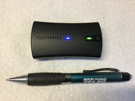

I use an Air ll with the Garmin GLO 2 this connects via Bluetooth to the I pad. Just turn it on, locks onto sats right away then it links to the Air 2 with Gaia for real time location, altitude, mapping. It is so sensitive if you move it inside the vehicle you will see the location move on the screen. Runs 13 hours on a charge. Charges while operating via supplied adaptor and USB cable. $99. Works great!A5A879AF-CD66-440F-A1EB-6E08D21489A2.jpegD3017694-4CD5-4DC8-9F94-3E2578C55E56.jpeg

I use an Air ll with the Garmin GLO 2 this connects via Bluetooth to the I pad. Just turn it on, locks onto sats right away then it links to the Air 2 with Gaia for real time location, altitude, mapping. It is so sensitive if you move it inside the vehicle you will see the location move on the screen. Runs 13 hours on a charge. Charges while operating via supplied adaptor and USB cable. $99. Works great!View attachment 97878View attachment 97881
My setup as well. Works great!!
I went a similar route. I tried using my WiFi iPad with my iPhone but it was way too unreliable. Bought the Glo 2 because I don't have an InReach and it works great. I
