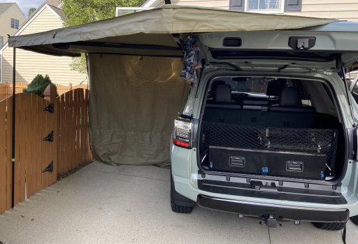

I have an Ironman 270 Awning that I got for a steal at an Expo a couple years ago. Once we put it on, we realized that the standard mount wasn’t high enough for us to open the rear hatch of our 4Runner completely. Has anyone else had this issue? How did you solve it? I take the awning off for winter time and figured I could figure out a mount to try in the next month. I am guessing it is about 2” or more that would need to be cleared.

Do you notice anything with extra wind resistance or noise with it being that high?

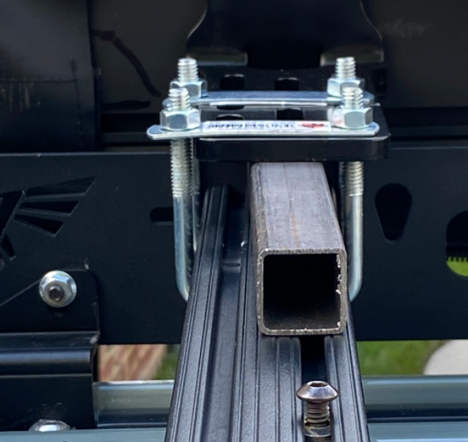

I do not have a picture of the final setup, only the picture below from mock-up. The picture shows a 1x1 spacer below the awning mount to see if that was high enough. It was and as I stated above and I welded two 1x1 pieces side by side to make a spacer equal in width to my cross bars.
I used U-bolts to secure the mounts to the crossbars as I did not trust using 1/4-20 screws in T-nuts in the slots of the crossbars due to the large leverage created by the awning. And I replaced the mounting plates that came with the U-bolts with plates made from 3/16" steel as you can see the original ones were thin and tended to bend when tightened down.
There is some noise, but I never had it mounted lower so do not know impact of mounted height on noise.

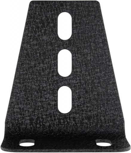

Bush Company makes some very sturdy brackets that would likely give you the height you need. I ran these with t-slot crossbars and 1/4 -20 t-slot nuts with no issues with my OVS 270 awning.
Awning Heavy Duty L Bracket
Gotcha! I have never came across this search. I will need to get the dimensions and see if this will work
