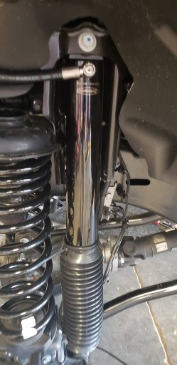

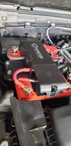

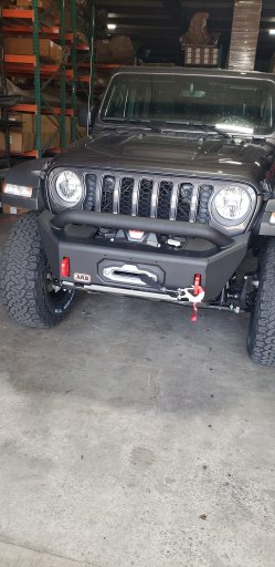

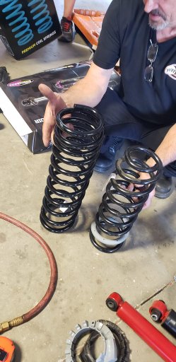

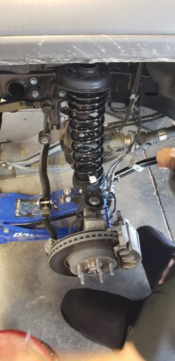

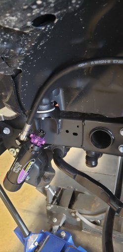

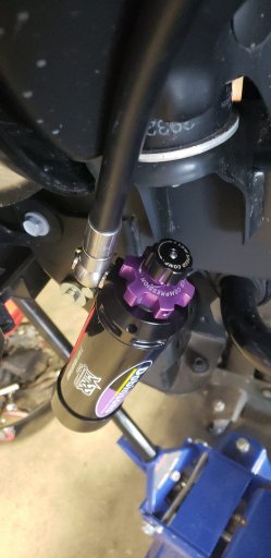

Last month picked up a new 2023 Gladiator Rubicon 3.6. First things first. I knew I was going to be close to gross max weight so the suspension was the first thing ordered and installed. I went with the Dobinson's 3-inch heavy duty lift with all the components. The 3-way shocks, the heaviest duty springs and all the extensions. I also ordered and installed the Genesis 3rd Gen. Dual Battery system with dual Odyssey Group 25 Batteries for my "in cab" power needs (I tend to run a lot of electronics that I keep on full time in the cab) . I installed the ARB "stubby" front bumper with a Warn Zion 10k winch with synthetic rope. I went with the MOPAR 81/2-inch-wide wheels because I wanted to go with the KO2 35 inch tires. My snorkel (AEV) has arrived as have my dash bar for my electronics which will be installed along with 4 USB and 4 12 v hard wired outlets when I get my Gladiator back from the Camper build. I will also be installing the ARB Diff covers and Breather tubes.

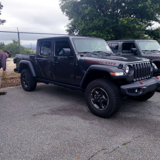

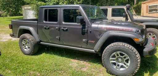

Once I get the truck back I will be installing all the parts that have arrived since the truck has been in North Carolina for the camper install and I will be deciding on what lights I want (more than likely doing the ARB suite of lights). Deciding on how I want to build out the inside after a trip or two in the truck and searching for a rear bumper that will allow me to get my spare tire out from under the bed. I am also trying to decide on which brake upgrades I want to go with. I am currently geared at 4:10 and depending on how the truck runs with the extra weight I will decide if I want to regear. Here are some pictures of the first part of the build.
