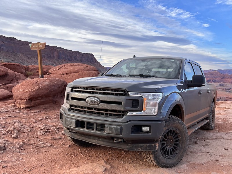

Back in the summer of 2020, you could still get a good deal on new vehicles. I brought this brand new F-150 XLT home that July. Got her for $43k ($10k under sticker) + 60 months same as cash. I pity folks buying today :(
Had the hood shield and window deflectors on the following week, along with a catch can under the hood.
Put about 600 miles on those lovely white-letter Michelins before swapping them out for some 33” Dick Cepeks. Also fitted with Bilsteins at 2.5” and 3” blocks in back.
8-year-old for scale.
Found a factory wheel on eBay, and had another Trail Country tire spooned on. Full size spare, plus 5-wheel rotations. Fits nicely under the bed.
Did the LineX thing.
By November 2020, I started getting ready for a solo trip out west. Still only had about 2500 miles on the truck at this point.
Wired up a dash cam.
Took off the front dam and installed PDM 1/8” aluminum skid plates.
Installed a RetraxPRO XR tonneau with Yakima rails
And a basket…
Added some Hi Lift tube mounts on the basket for the jack
Packed up at 5am the day after Christmas 2020, stopped to top off the tank before hitting the road!
Pretty basic camping setup, but it got the job done. Visited some amazing places throughout the southwest – spent 5 days at KOFA, plus Organ Pipe, White Sands, and a whole lot more. Put about 5.000 miles on the truck in 12 days, with about 400 miles off road.
I’ve only done a few weekend camping trips each year since then, but I got the bug bad this year and am planning another solo winter trip. But lessons were learned, and I’l be making some changes to the rig. I’m ditching the tonneau, rails and basket (for sale, cheap!), and installing Decked drawers, a KB Voodoo VRS rack, OVS RTT and awning.

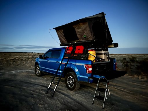

Coming together.
I wasn't particularly confident in the rigidity and general structural soundness of the VRS rack as it was, so I ordered extra panels and top rails to help stiffen it up. Frankly, rack is like a freaking erector set. I'm still not supremely confident in the six brackets holding it all to the aluminum bed, but I'm heading out Tuesday, so at this point it just is what it is.
Starting to get things mounted up on the rack
Replaced the factory running boards with some GoRhino "sliders" – they're not really sliders, but they are much more heavy duty than the factory running boards, and they're snugged up nicely to the body and don't hang down like the factory ones. They're there to help prevent damage to the rocker panel and give me more clearance than the factory running boards.
Got a few buddies over yesterday to help get the tent up there.
With the drawers loaded up, the weight of the rack and the 200lb+ tent, the truck was not, um, handling its best. Considering I'll have at least 500lbs in the bed constantly, I had some Super Springs put on to help with the increased payload. They work marvelously.
It's raining today, but I needed to get the tent set up, aired out, and tried out!. Going to sleep in it tonight and see how it goes. Shouldn't get any colder than 48F here tonight, so it should be fine temperature-wise. I'm more curious about how the memory foam "mattress" is going to feel. We'll see.

Back home now, after 4600 miles. Hit 5 national parks and two national forests throughout the southwest, plus a bunch of other stops. No real off-roading this time ‘round, but plenty of roads and conditions that required 4wd and clearance.
The Decked drawers were awesome. I had them packed full of all kinds of heavy gear, and they functioned flawlessly.
The Decked Cargoglide had some issues after it was loaded down with about 300lbs, mainly due to what I believe is a design oversight for the F150. The truck has a 3/4” protrusion on the bed bulkhead that doesn’t give the cargoglide enough space - when fully closed, the back of the drawer is pressed tightly against the bed, and it’s not supposed to be. If that protrusion in the bed wasn’t there, it wouldn’t be an issue. Being that tight made it extremely difficult to get the cargoglide out from its closed position. On day 2 of the trip, I stopped by a Home Depot for a rat tail file, and filed out the last stop position hole in the cargoglide frame about 1/4” so the locking mechanism could engage sooner. Then touched up the file point with a paint pen. It did the trick.
The VRS rack seems to have functioned ok. I had to go through and tighten up all the nuts every few days. I’m still not confident this can be a good off-road solution without some fortification, which I will be looking at doing very soon.
The OVS Sidewinder tent was pretty awesome. It’s my first RTT, so I don’t have too much to compare it to, other than a variety of ground tents. The mattress is great, and I have no desire to upgrade it. It’s pretty easy to get set up and taken down - after doing it a few times, I’d say I can set it up in 2 minutes and take down in 4. The long hooks for the rain fly secure to 2 aluminum braces in the tent frame t-slots. These aluminum braces deformed quickly, and would be better if made from steel. The tent’s inner frame is easy to swing out and extend - a very smart design - but the extensions are secured by plastic quick-release clamps, and one of those broke before I left, so I kept a pair of vise grips in the tent to secure the frame once extended. I could have avoided this by properly adjusting the QR clamp before strongarming it, though. That’s on me.
All in all, I’m pretty well satisfied with how everything turned out.
