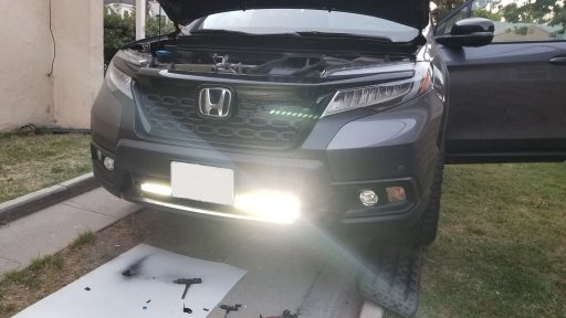

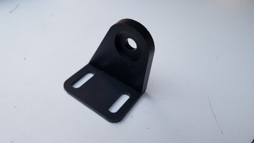

I've finally made time to finish my 30" Light Bar install and wiring. The brackets that came with the light didn't have the clearance to allow for proper adjustment so I had to machine replacements. This became the first project for me to learn to use my new CNC router. I cut the brackets in two pieces from 6061 aluminum plate. Making my own brackets allowed me to position the light precisely in the lower grill.

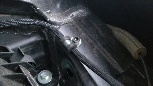

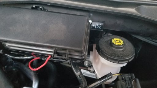

With the mounting sorted out, I turned my attention to the wiring. There's no easy way to get through the firewall on the Passport so I had to find another way to run my switch wire. Honda has a lit running board that uses an access hole under the driver side floorboard that was a convenient place to fish the switch wire without needing to go through the firewall. I wired and mounted the relay directly to the fuse block under the hood for continuous power with the switch cable run down the inside of the front driver's side fender. There was enough wire to run the switch under the carpet into the door sill and for it to emerge and mount just over the hood latch.
View attachment 103979View attachment 103978View attachment 103980
I couldn't be happier with the end results...
View attachment 103982View attachment 103983
Before: After:
View attachment 103984View attachment 103985

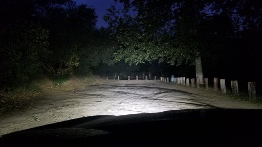

My goal for this light was to act as a relief light, helping bring out the texture of the trail. I'm not planning to do any high speed off-roading so the idea behind high mounted spot lights is less important for me, but I'm mostly concerned about ground clearance, so having a light that will help me judge the height of obstacles. You can see for the photos that the idea worked, having a low mounted bar brings out the shape of the terrain, I'm looking forward to my next trip to really put it to the test.
