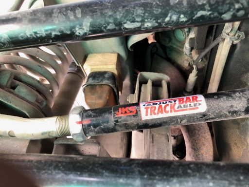

In prepping for the trip I installed an adjustable and beefier trackbar, and advice was to extend the bumpstops to keep the larger diameter bar off the oil pan. In the rush I purchased a set of mount extensions from Amazon. Well, I was impatient making my way through Saline Valley and ran it up to 35-40 MPH. At one point I hit an erosion cut right across the road and bottomed out. By the time we were on the Warm Springs cut off, I could hear rattling from underneath. I did bottom out, and completely collapsed the cheap boxed metal bumpstop mount extension. The track bar left a slight deformity in the oil pan and bent the transmission cooler lines. So close to disaster again!
At camp the next day I made the trail repair. An almost petrified 2x4 was found and thankfully I had a saw and another had a 12v power drill. I made and installed a bumpstop spacer from the 2x4 and it worked wonderful. At some point later I made a set of solid aluminum blocks so this will never happen again and I don't have to worry about termites).
