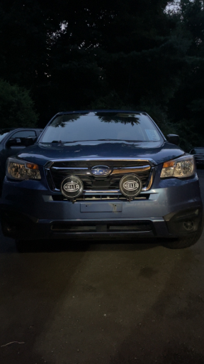

I love the look of round lights over LED bars. I mounted a pair of Hella 500's to the bumper with a piece of Unistrut and then cantilevered some plates through the grill. Here's a CAD model of the assembly:
View attachment 69249 View attachment 69250

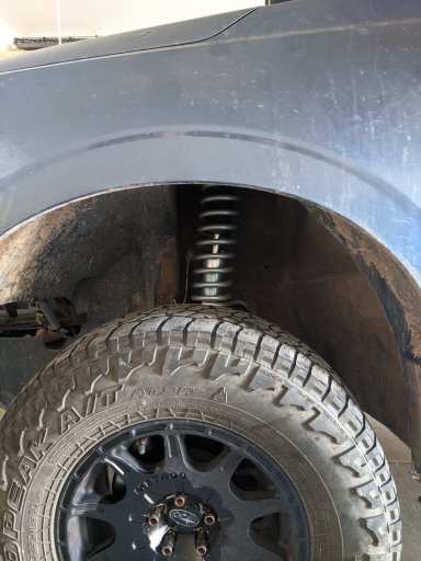

Flatout Suspension GR Lite adjustable coilovers. These allow me to fine tune my ride height and stiffness as well as provide more suspension travel. Although they're shown in the photo below, I also completely removed my front and rear sway bars.
View attachment 224026 View attachment 224027
