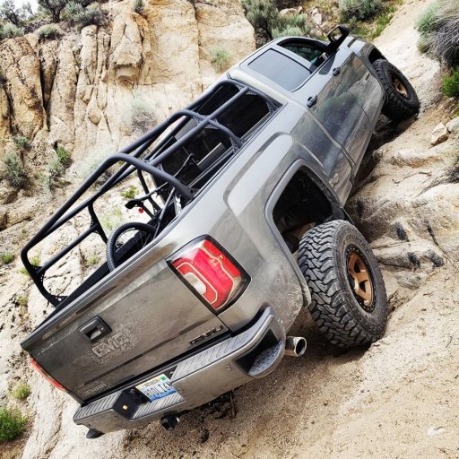

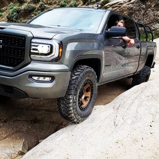

Here is my Denali build.
Dirt Kings UCA
Fox 2.5" Remote resivoir coilovers
285/75/r17 Toyo Mt's
17x9 Method Con 6
All Pro Tundra WIY Bed Rack Modified for Sierra Bed (not completed yet)
S&B Air Intake
All Chrome removed and color matched or replaced with OEM black pieces
Truck had a 3.5" rake when new and now sits perfectly level. Here are a few pictures from along the way.57568373_10212815424251450_1472497419668160512_n.jpg59301214_10212901972735108_8082804361429778432_n.jpg60473395_10212997387640421_8323902814447206400_n.jpg60729054_10212997385960379_8435651695916089344_n.jpg61803783_10213090327883869_4642553862484393984_n.jpg61818250_10213090327403857_1022835582390239232_n.jpg61867409_10213090328363881_5026109130805346304_n.jpg62309317_10213090328123875_1177896228331978752_n.jpg62219290_10213090327643863_8335706230685171712_n.jpg61943776_10213090329403907_5103923054761738240_n.jpg61973113_10213100167969865_4132057550080180224_n.jpg

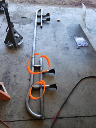

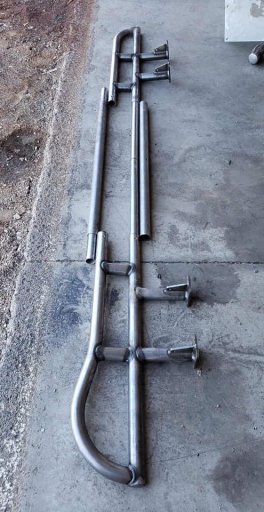

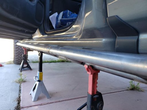

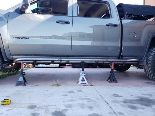

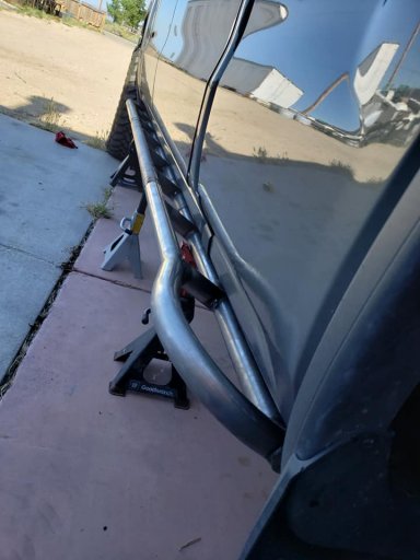

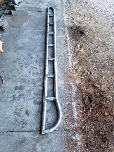

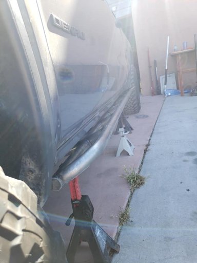

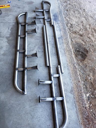

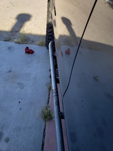

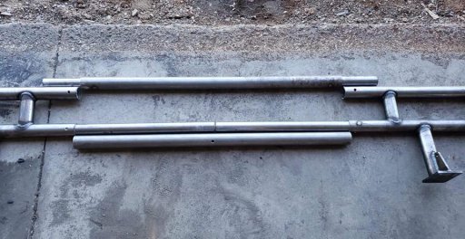

Today I started sliders for the Denali. Had a set of 68" savage offroad sliders from an old project I have been trying to sell. No luck, except low ball offers, so i decided i would just modify them to work. I extended them 36.5"s to make them 104.5"s. Perfect for my true crew cab with a 6'6" bed. Just need to make 3 small tube braces, circled in the third picture. They will weld to the two "removed" 36" tubes and then slide those between the two end pieces. Weld the joints solid and fill the rest of the rosette welds. Then figure out how I want to mount them to the frame and make new legs from 1.75x.250.
The original sliders were 1.75x.120 wall. I fully sleeved the tube closes to the frame with a piece of 1.5x.120 wall making it .240 wall. The "rub rail" is just sleeved with 10"s of 1.5x.120 wall for each connection. You can see the 5" sticking out of the removed tube.
How would you mount, or how have you mounted to these new frames. I hear mixed opinions on welding or not. As of now I intend to weld them to 3/16 plates which will be welded to my frame.

***Update on the sliders and pics of intended locations. Just need to make the 6 legs and decide on how it will mount to the frame.
