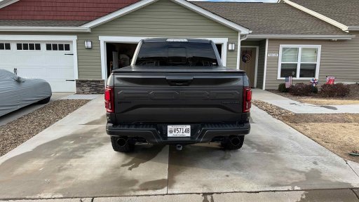

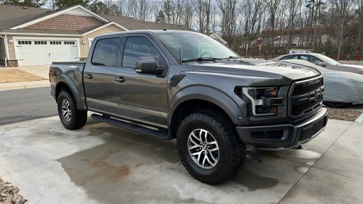

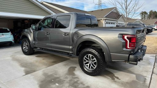

This isn't going to be to much of a build. I just purchased this last month, previously I had a 2019 F-150. I'll never do any hard core off roading intentionally lol, but you don't always know what you may get into.

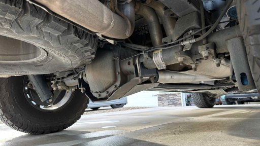

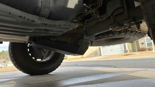

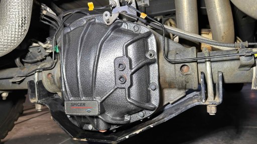

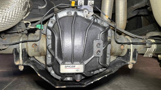

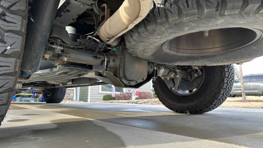

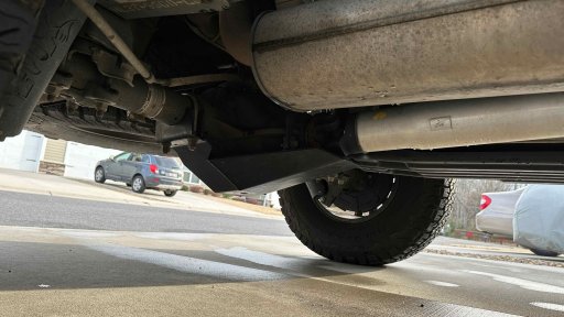

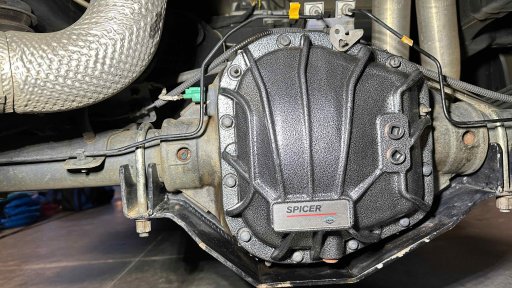

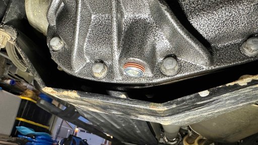

I carried over a Krazy House Customs differential skid plate. I really like this skid plate because it doesn't use the rear diff cover bolts as a mounting point and it has a spine the runs down the center formed to the diff. This is a stout, thick steel piece and I feel very confident in its ability to protect the diff.

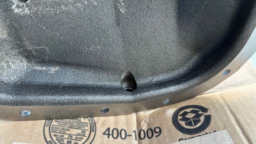

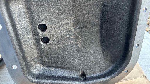

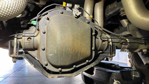

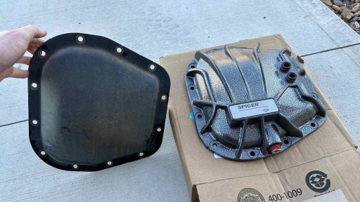

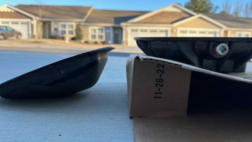

Tonight I installed a rear diff cover. The Ford Performance diff cover is made by Spicer, but costs $100-$150 more because is has a Ford Performance emblem. I was able to get the Spicer branded cover for $129 and I purchased a LubeLocker gasket to go with it as well. I use Amsoil fluids throughout. Following the tightening sequence provided with the gasket, I torqued to 15 ft lbs on the first pass and 30 ft lbs on the second pass.
