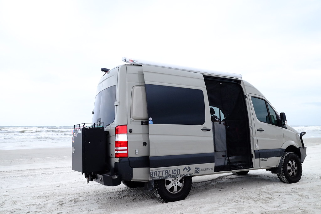

I actually like this thing, but we decided after a dozen or so nights, we want a different layout. It is actually easier and faster for me to just do a full build again and how i want, instead of removing, replacing paneling with mount holes in it, then rebuilding everything in the layout i want. So, I'm just going to sell this one and redo it! Plus i want a different color.
99,999.99 USD
currently 4500 miles on it. Going to arizona for expo west, so mileage as traveled.
Can be delivered at overland Expo West.

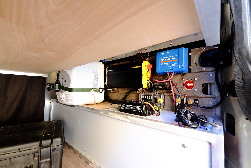

Electrical
3 x 100w Renogy Panels Mounted on roof with Aluminum angle brackets to the factory roof rack rails
Solar gland on roof
8 ga wire to charger
Victron Connect 100/30 MPPT charger with bluetooth
Victron Connect BMV-712 Bluetooth battery monitor
2000Watt modified sine inverter
200AH AGM Battery
4ga going from builders terminal to rear
Blue Sea battery shutoff
CTEK DC to DC charger after shutoff to charge from builders port
Two switch panels (one in rear and front)
Both control lights and water pump, in addition to other front/rear needs
LED lights in ceiling
Multiple 12v and USB ports
Blue Sea fuse panel and components
110v, 30 Amp Marine grade 3 bank Battery Charger for charging from shore power (future battery additions)
6 switch integrated relay box for compressor/lights on exterior
Midland MXT115 GMRS radio
Majority of 12 gauge wiring used in vehicle for additions

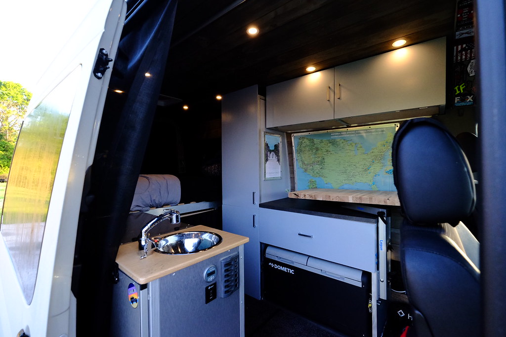

Sureflow 3gpm water pump, strainer and accumulator
Rear door shower/sprayer quick connect/disconnect
Sink in trail kitchens unit with drain to 6 gallon water can

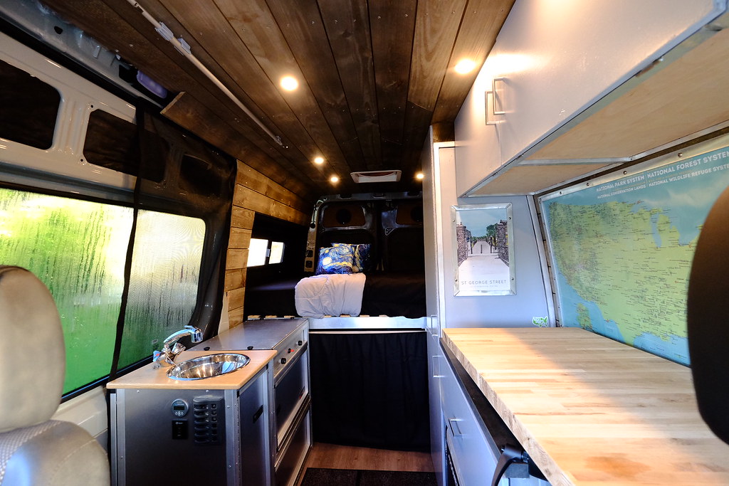

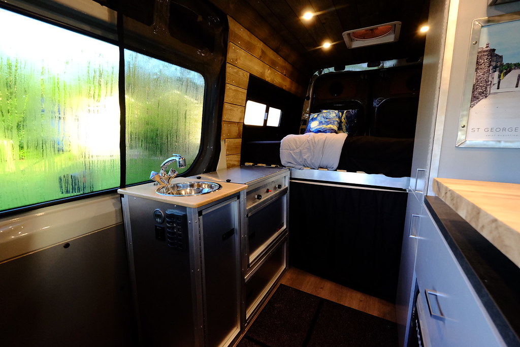

Shiplap interior paneling
Trail Kitchens Van Kitchen
Sound deadening in entire living area and doors
3m 2" Thinsulate in entire living area and doors
Rigid foam insulation in floor
Espar D2 heater under passenger seat
Seat Swivels
Lagun Table and butcher block top

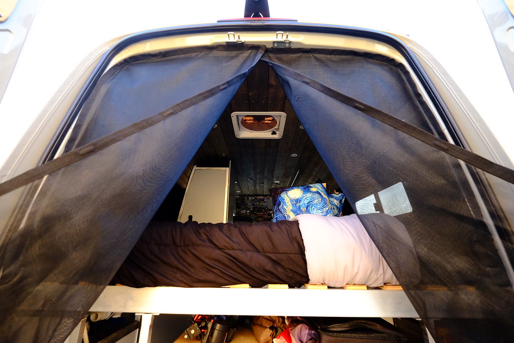

Ikea Foam Full Size Bed

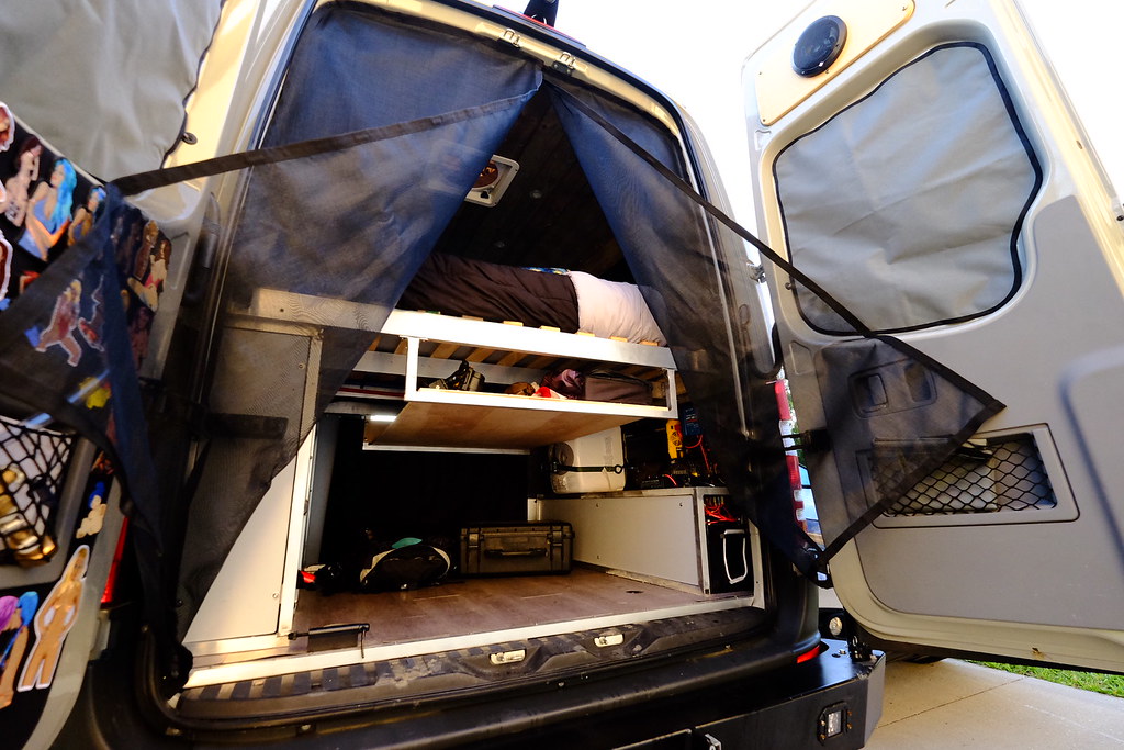

Fully custom built aluminum framed with wood inset structures to reduce weight.
Bed frame mounted on brackets to the wall from 1 x 3 aluminum
All cabinets, and underbed structures from 1" square aluminum
Flarespace flares were lined with foam them carpet for insulation and sound deadening
All doors and drawers have catches/latches to prevent opening while driving
All items are securely fastened to prevent movement during traveling or accidents
The only thing left for someone to do (if they cared) Is to finish the sliding door (current as is from the factory on the interior minus sound deadening and insulation that is done) and to trim out the very back (c pillar?) if they wish. Past that, this is a full functional and complete build that has been trail tested and wife approved.

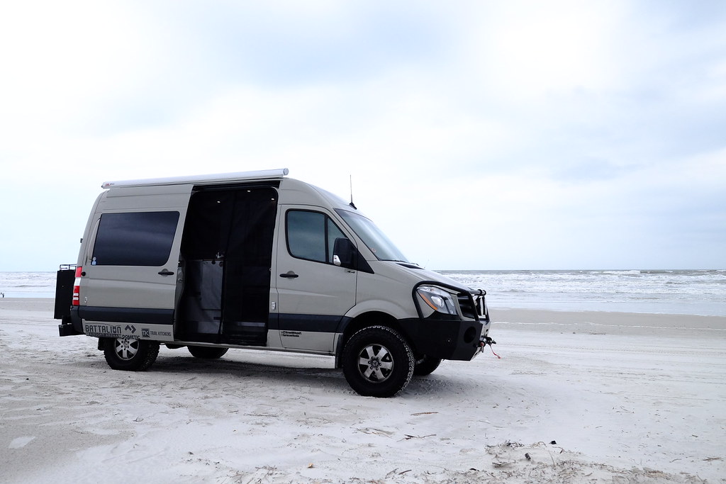

Sprinter 4x4 by Grant Wilson, on Flickr
