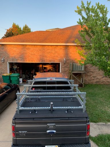

Pretty much finished now. I still have to put a couple of support L braces on front rack for more stability but for the most part it's done. I will plug the ends of the Superstruts before painting, no doubt it will look a lot better once painted black. Functionally it's perfect, allows me to put a RTT on top, still have space underneath for storage and I can still open the front half of the Diamondback cover when a RTT isn't mounted on top. I'll take another picture when I get my traction boards mounted on the side. I'm also
working on a water solution with PVC that will mount on the back half of the Diamondback cover.

Yep, built with Superstruts and 1/2" stainless hex & carriage bolts with nylon lock nuts! Still kept the overall cost around the $250 range. At some point I'll try and figure out my exact cost, hard to say due to my having to take back and exchange things pretty regularly in the build/design phase! Might be easier to just count all the hardware I ended up using and then go to Lowe's and price it out, I'm curious to what the exact cost was.

It was way cheaper than the ones I priced online like the RCI one on saw on a truck on my way to work, $750 for that one. I went to a guy who builds stuff with aluminum and he told me what I built for around $250 would cost at a minimum $800. I'm happy with it, love the fact I can still open the front area of my Diamondback cover which is essentially my tool box!

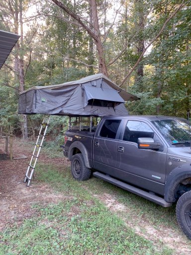

Well just spent my first 3 nights in my Overland Vehicle Systems Nomadic 3 tent and let me just say it was super comfortable, no worse then sleep on your average bed, even better than what I would say is average! OVS did a good job with their 3" mattress, didn't feel any bumps or uncomfortable spots!

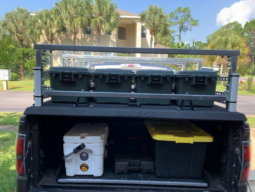

Another thing I like about having the Diamondback cover is I can use it combined with the RTT rack to secure my Plano storage totes, 4 of the smaller ones fit perfectly across the back!
That's a pretty good setup. I like how your able 2 utilize the top of the cover and still get into the bed, and open up the tent too. It's a great build
