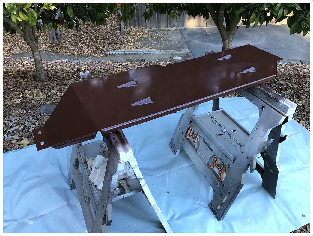

Pelfreybilt steel gas tank skid plate.
I went with steel since aluminum can get gouged increasing the friction when sliding over rocks. I went with the Pelfreybilt because I liked the way they protected the mounting bolts, though this will make it harder to reverse off of obstacles. Paint is Rustoleum red oxide primer and then Hammerite (not shown in picture). I used this same combination on my 4Runner's rock sliders and it has held up really well and is easy to touch up.

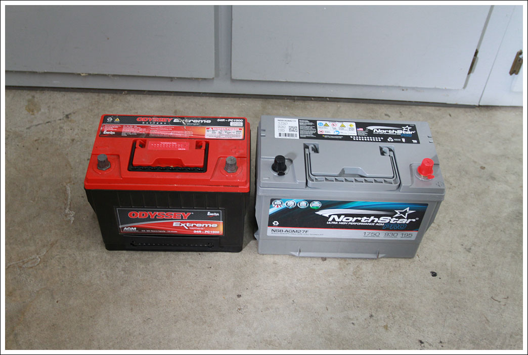

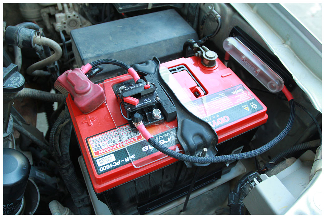

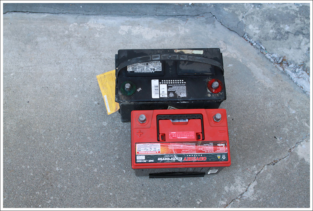

The original battery was leaking so I replaced it with a Odyssey Extreme 34R-PC1500. I've had really good luck with the Diehard Platinum in the 4Runner which is still working after 10+ years and was supposedly made by Odyssey.
Size comparison.

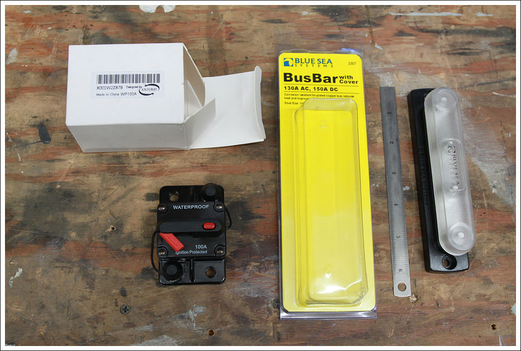

Parts I used to wire up my non-factory power circuits.

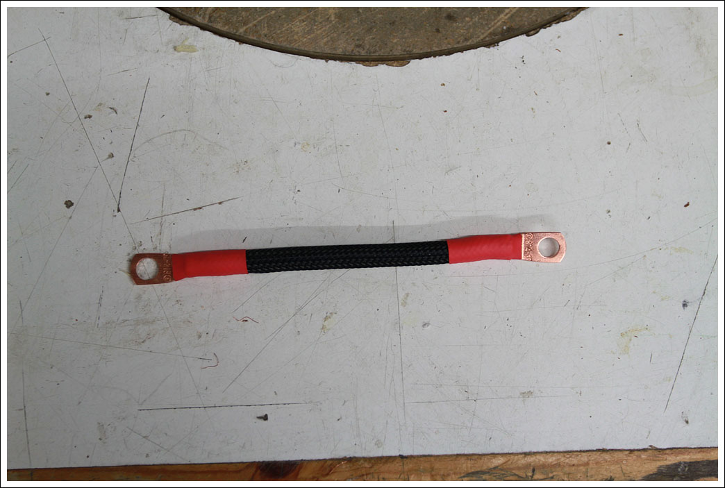

Custom homemade wires.
All wiring is 8AWG which should safely support 100A at these short distances. The 100A circuit breaker is used to protect the connection to the buss bar and to provide a single on/off switch for all non-factory electronics in the truck. The buss bar provides a convenient place to attach high-current loads such as the air compressor and the Spod. All low-current loads run off the Spod. The breaker is mounted to a piece of plexiglass which is clamped under the battery tie down, and there's a spacer in between the two to prevent shorts if the breaker were to move. If I end up moving my winch over from the 4Runner I'll add a second larger breaker to power the winch.

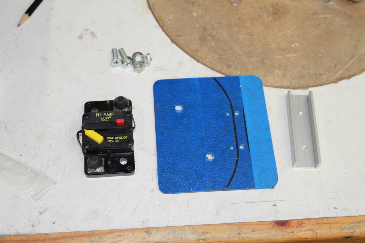

The 10+ year old Diehard in my 4Runner died so I replaced it with the Odyssey Extreme from the Tacoma and then bought a new Northstar 27F for the Tacoma.

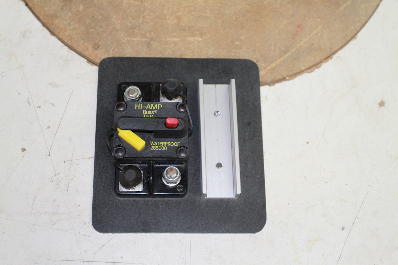

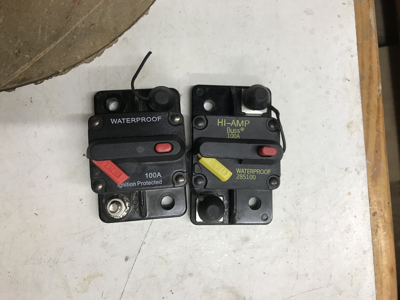

Then, on a recent trip to the Mendocino NF my 100A main breaker started tripping at ~50A load while running the ARB compressor (friend punctured a tire). I replaced it with a higher quality EATON Bussmann breaker which will hopefully hold up to the heat better. At the same time I rebuilt my breaker mount using delrin and aluminum.
The Bussman breaker is noticeably better built with thicker plastic and a more solid latching mechanism.
The delrin mounting plate and aluminum channel to keep it from moving around.
