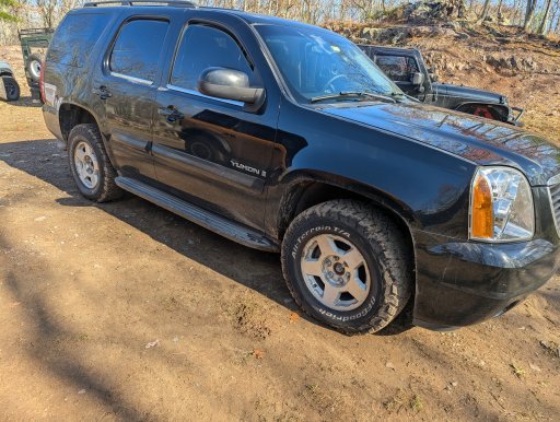

I am still new to overland and offroading altogether so now that I have that part also out of the way here is my build post:

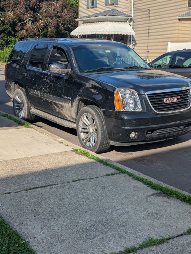

I purchased a 2008 GMC Yukon. It was on 22" rims that looked nice but weren't offroad worthy. Over this year I found a set of 17" rims on facebook marketplace.
They also came with all season tires that were in fantastic condition but the price was good. Few months later and I ended up scoring a set of 6 BFG KO3's
with approximately 70% tread for a price that just worked out great. Got them mounted to the rims a week later, have the all seasons still as a backup and
the 22's are also still around.
2008 GMC Yukon
5.3 with a odb2 AFM disabler
4 spd auto
4x4 with a G80
And here is the Yukon with the BFG KO3s aired down.

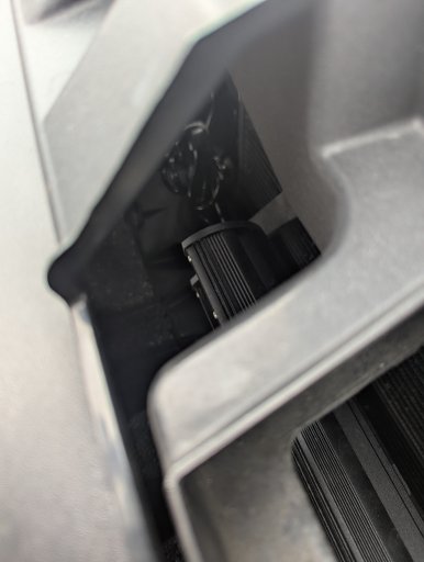

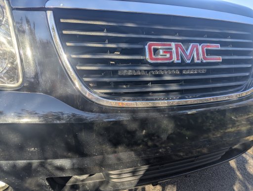

My first big upgrade I worked on installing was a light bar. I settled on installing it behind my grill after watching someone do the same on a Tahoe. At first
I thought the light would be blocked or limited but it clearly wasn't interfering. Once I saw how much light was given I decided I am doing the same.
Followed along with the video on how they mounted and ran the wiring. I'll do a write up but my pictures of the process never happened. I watched a video
on removing the grill. It worked better in the video on removing the grill than it did for me. I ended up loosening my grill enough I could work behind it.
So with the grill situation settled I found a metal bar running across in front of the radiator that did have some holes in it that conveniently would fit
the mounting screws on the light bar. The included screws however were not long enough to fit through the bar and have the nut screwed on. I have a set of
nuts and bolts from Harbor Freight and swapped them out. I did have to line up the bracket on the bottom of the light bar with the screws so they would line
up with the metal bar. Getting a nut onto them was 50/50. The driver side of it was easy but the passenger side one took forever to screw on.
Now by this time it's already dark out so I did test that it worked by connecting to my battery and just confirming the light bar turned on and was giving
off enough light through the grill. Following day I ended up connecting it to the battery in a better way and running the switch into the cab following the
path used in the Tahoe video I watched. Ran it up by the battery, underneath the hood and in through the passenger door. Ran it underneath the dash and
through the gap between the center console and the radio. Confirmed it worked once again using the switch.

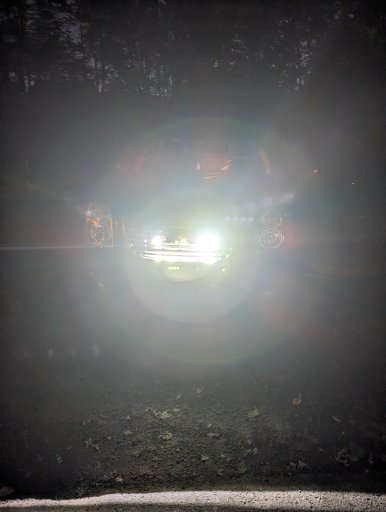

This light bar gives off more light than my headlights so that's nice. I also have two spotlights that came with it but I have yet to decide on how to use
them. Maybe I will mount them to the hood. Perhaps I'll mount them in the rear and use them for backing up at night. That is a project for next year once
it gets warm out again.

Here's an interior shot of using only the light bar.

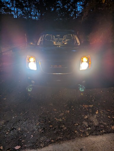

Next up is replacing my headlights. I recently replaced a burnt out bulb because the low beam went out. Today I found out my high beam is burnt out.
Going to try and run some LED bulbs and see how they perform. Halogen bulbs really lack light so hope to get better results on LED.
Current state of my headlights:

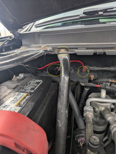

I have some pictures of how I wired it up. First up is an above shot so you can see the lightbar and the wiring.

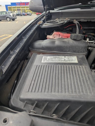

I ran the wire right past the radiator and it pops into the engine bay up near the air filter box.
Luckily the light bar had the wiring on the passenger side and the truck has the battery on the passenger side. I attached the relay to a nut on the body, the ground wire is connected to the body under another nut and the positive is connected to a positive nut on a fuse block.

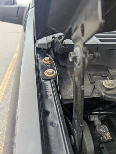

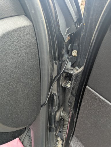

Next up I routed the rest of the wire underneath part of the hinge for the hood. I did some test opening and closing of the hood to make sure it does not crimp or in any way interfere with the wiring. The wire then pops out by the door hinge so it goes right into the cab.

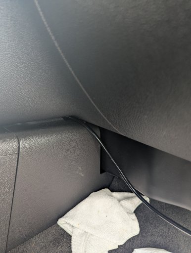

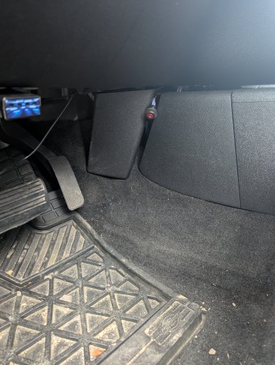

I haven't decided on where to mount the switch at so for now the wire is just ran across the passenger side of the dash over towards the driver side.
And the switch hangs out in the little gap here. One day I may end up mounting it permanently.

Thanks for the detailed pics. I've never done one so I'm interested how they get connected to the fuse block or of they even have to.
.woo, you are taking a couple of chances there, at the hood and the door. Is the cable long enough to make it to the drivers side? There are definitely some ports and grommets there where the cable can pass safely through the firewall. Probably on the passenger side too.
At first I was hesitant on running it this way because of the hood and door. This lightbar came with premade wiring. I was looking to run it through the driver side but I wasn't sure how well this wire would hold up stretching above the engine. Over the past two months I've kept an eye on the wiring and it shows no signs of hood or door making contact with it. Maybe next summer I'll look into running it better. For the winter it stays as is. If it does get compromised I'll update here.

Well the LEDs aren't any better or worse than the stock lights. One side is still brighter than the other. My driver side housing has a broken tab so the whole thing bounces around. I did find a nice pair of new headlights but at $1k for them I really can't justify that expense. Going to shop around or hope the local pull it yard ends up getting a yukon of this generation in.

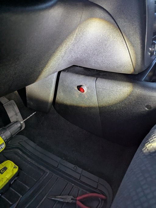

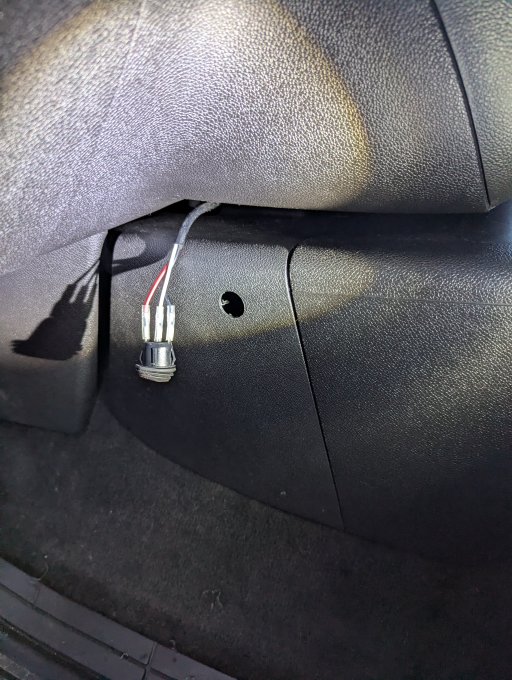

Got around to mounting the switch for my lightbar tonight. Used a 3/4 spade to drill out a hole under the dash, and used some files to smooth it out and make a few notches to line up with the tabs on the switch. Probably could have done this sooner in hindsight. If I ever decide to redo the wiring or add more stuff I figure a small hole down under the dash area really won't bother me if I move the switch out of there.
