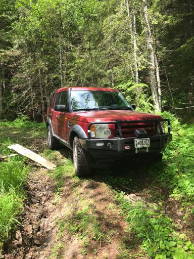

So there's basically a stock Rimini Red LR3. In the above picture, it's sporting a 2" lift via the GAP IID Tool. For those of you not familiar, the IID Tool is an ODB2 interface specific to Land Rovers. This tool can log into the various computers of the LR3 and you can manipulate a plethora of settings, including the air suspension. I had raised the suspension to get an idea of sway because the day after this picture was taken, I added 275/65r18 BFG KO2's.

IMG_3733.jpg PS, KO2's obviously are not good mud tires. That hole snuck up on me. It definitely looked more solid than it was.

I finally found a nice Warn XP9000 winch to put in my ARB bumper. I spent a Saturday installing the winch and the bumper. It was a chore but not to bad. If you have an LR3, just a word of note, there aren't a lot of ground spots on the left side of an LR3. I found ground studs buried under a bit of stuff and used that for the ground spot for my winch.
I also had an idea a little while back about on board air for the Rover. I opted for the ARB single compressor due to size and how it fits where I wanted to put it. As you can see in the picture, it's a great fit. It was very easy to install. It took about 2.5 minutes to air from 10psi to 40psi on my 275/65r18's. That's quick enough for me. I intend to put together a small air tank for tools but I don't see that as being a necessity yet.
