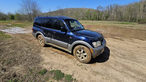

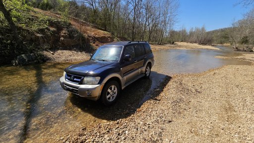

Hello all. I recently bought a 2005 Mitsubishi Montero Limited with 134k miles for an overland build. Hoping to document the process here. It is currently completely stock. I did some light to moderate trails on the way home from buying it. Even in stock form, it was pretty impressive. I was by myself and without any recovery equipment, so I did not want to push it much. Can't wait to see what it can do.
I have a list of modifications in mind, but what would all yall suggest? Where should I start? Anyone here familiar with the Montero?
