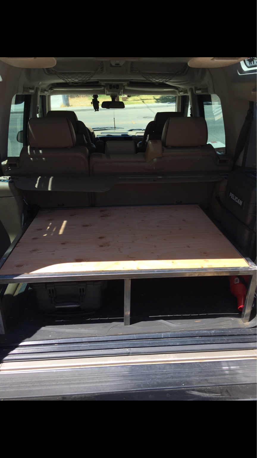

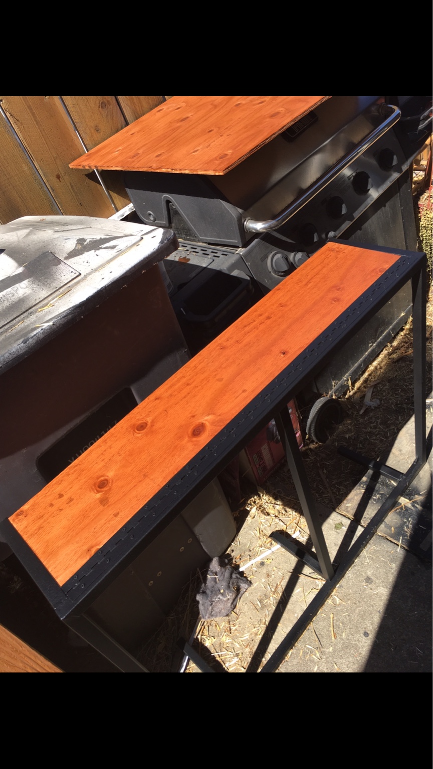

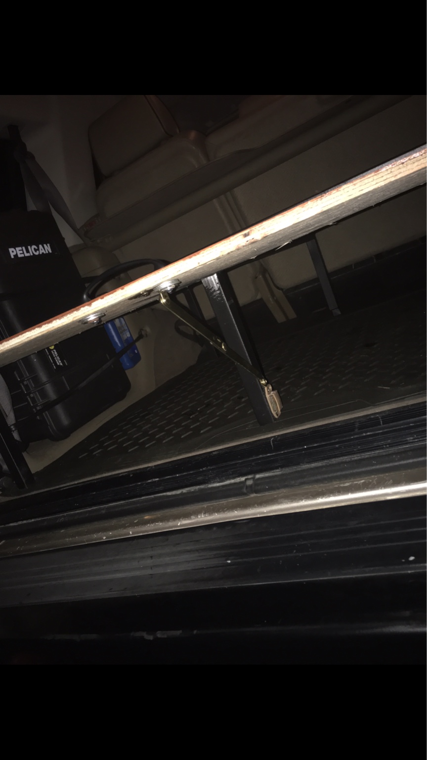

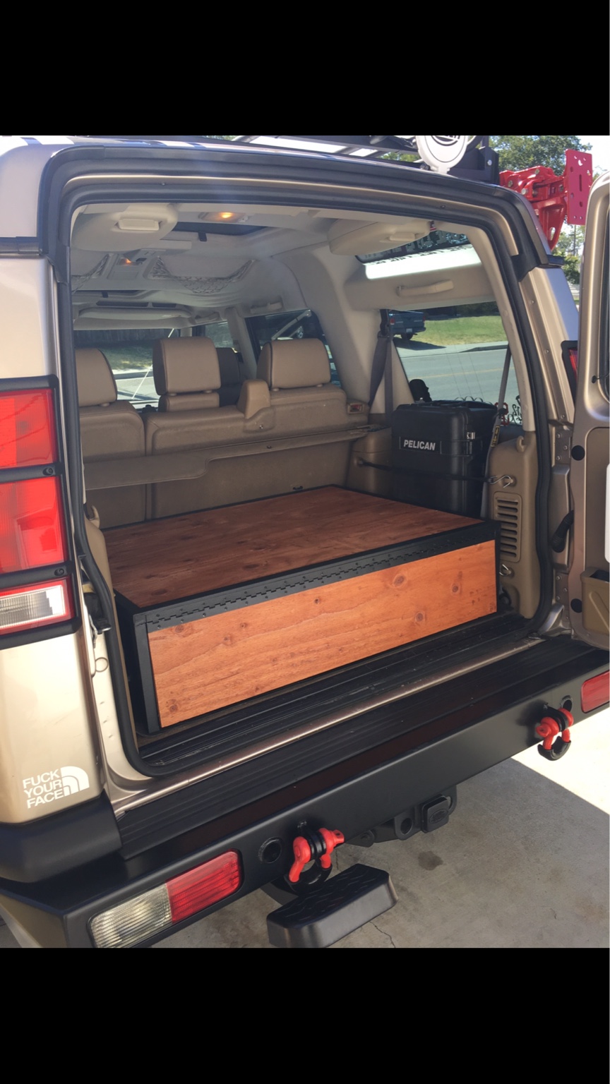

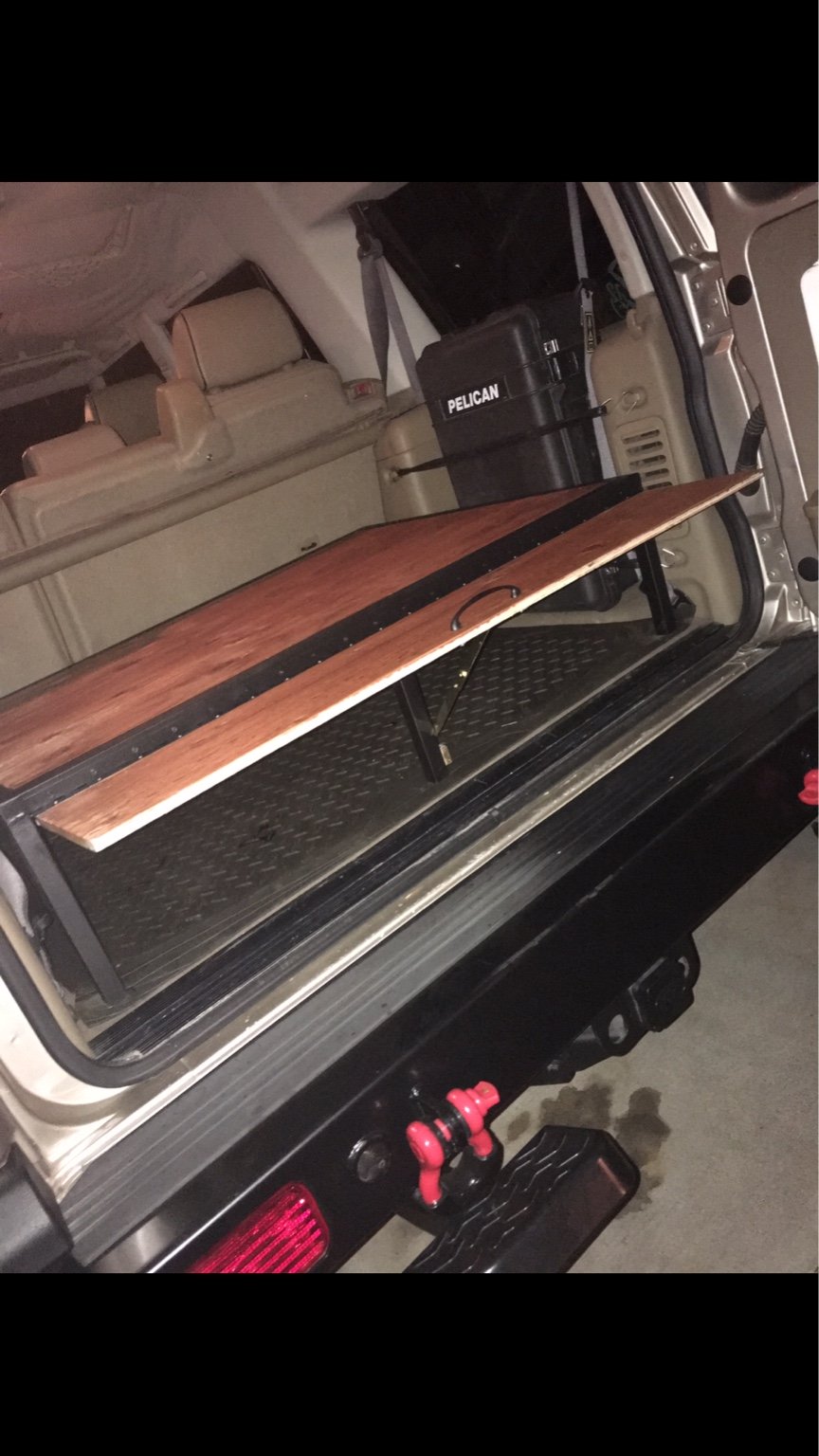

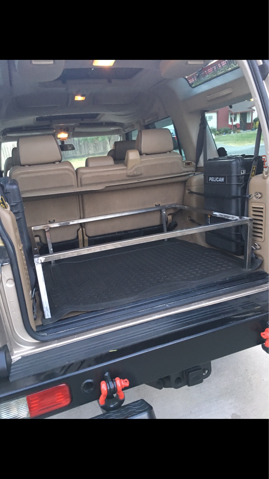

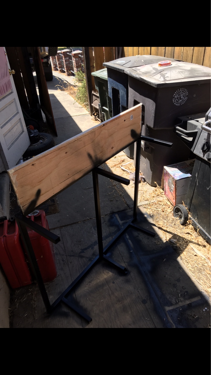

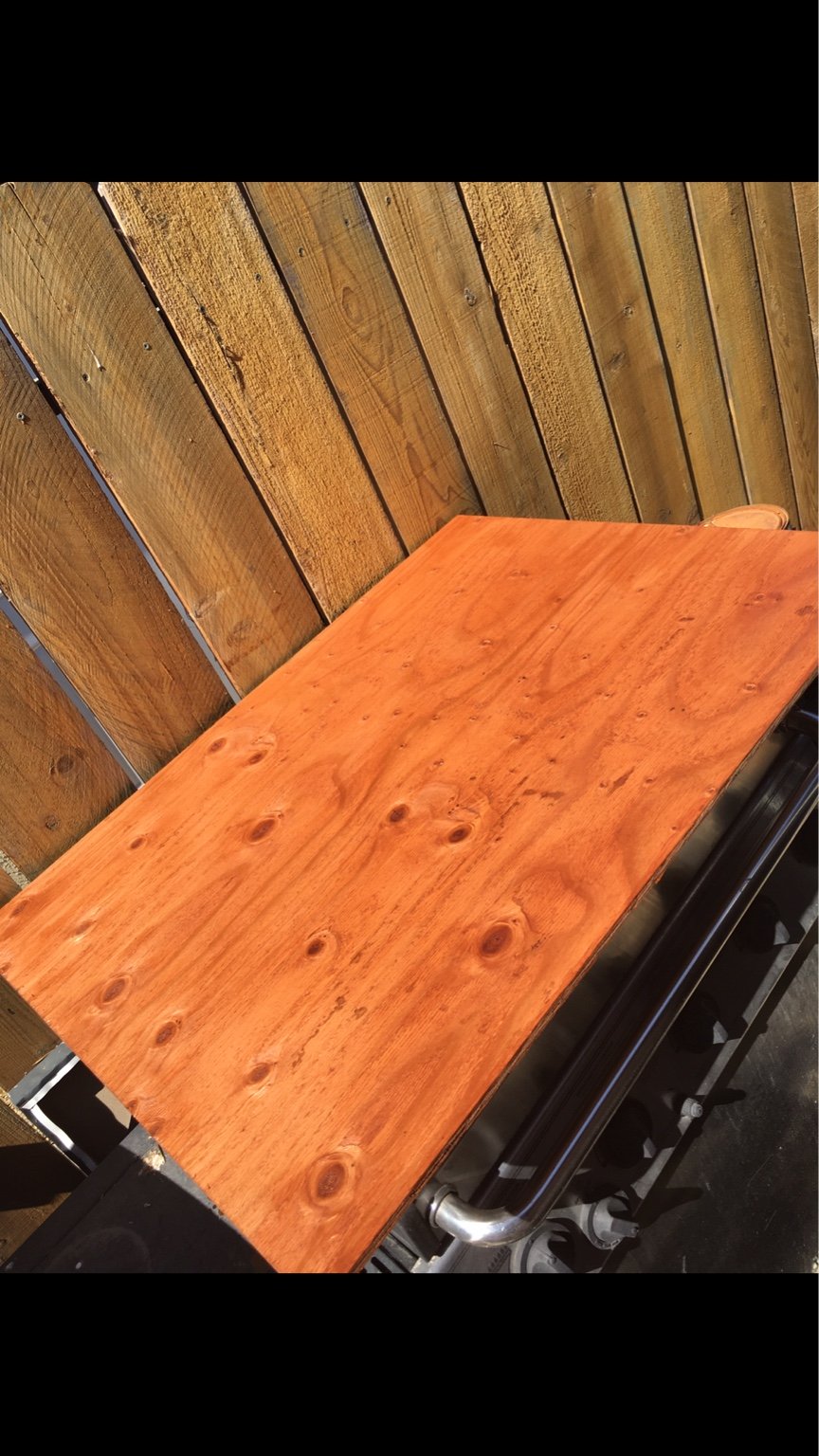

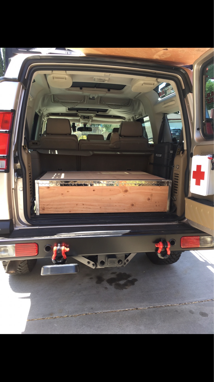

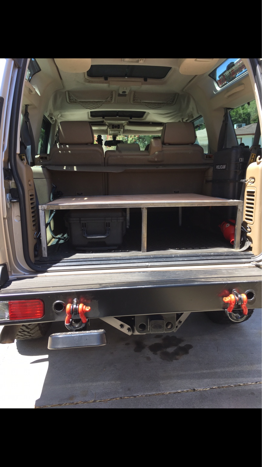

I want the rig to be more of an overlander so I started to construct a rear box to house my recovery stuff and other accessories, I made the height of the box to match the height of the rear seats when folded down for an air mattress bc it'll be a bit bf I get a RRT. I welded a frame and then sprayed if with TBL and stained the wood and added a piano hinge and locking hinge to keep the lid up,
This is where I'm at at this point, more to go when time and finances allows! Thanks for passing by and checking out my progress, I'd like to thank Atlantic British for all the how to videos on YouTube, I truly couldn't of gotten the rig done without them!

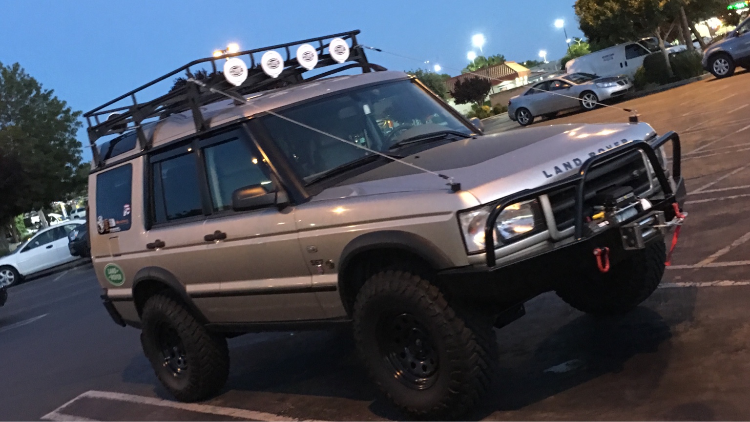

Are those rims from Lucky8? 16x8 or 16x7 ?Having a hard time finding some that don't have crazy backspacing. Trying not to stick them out passed the fenders.
