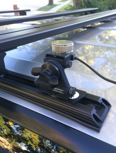

bladerunnerkc
1,059
Kansas City, KS, USA
12964
bladerunnerkc... That's a sharp looking antenna installation!
I had to keep the mounts low as I was parking in a garage downtown and my garage door is low. This just gets under both.
It's actually a Comet lip mount. I cut the lip mount part off and drilled for the two bolts that went into the T-Nuts in the FrontRunner tracks. What's really nice about these mounts is that they are adjustable in all directions so you get a nice vertical AND they have the thumbscrew so you can lower the antenna easily. Antennas come off both ham and CB though generally to avoid theft etc.
