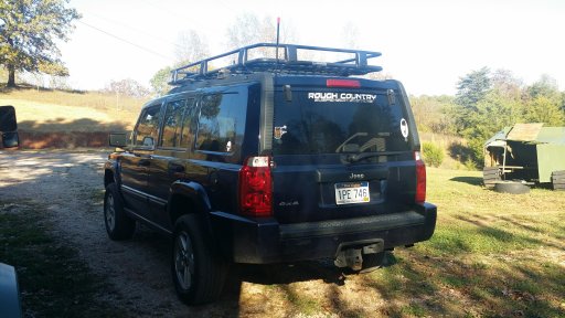

Bought my Commander in December of 2016 and been modding slowly as money will allow.
This was when I first went camping and had Windows Tinted

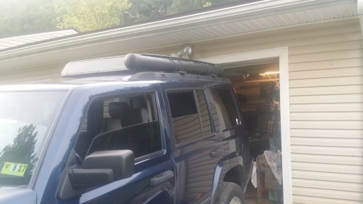

Built a PVC H2O container for showers and any other need while out. (Holds 4 Gallons of water)
Added alittle angry eyes to the rig.
More progress as I do them, next add on is a CB and a spare tire carrier for the rear, and new Tires

Can you tell me how you attached that ARB rack? I have an 06 Heim limited and I am so confused about how to attach these new platform racks. Did you find feet that fit the factory rail channel or did you attached directly to the crossbars?
Also, what size rack is that? It looks great and I would like the same thing.
I attached it with I bolts coming up from the cross bars thru the grating on the ARB rack I had then. I also then changed out the cross bars with unistrut to lower it down some closer to the roof while still using the factory legs to mount it to. I may still have them out in the building i could take some pictures for you.
Thank you, good idea. The factory crossbars have quite a bow to them, so the unistrut is a great idea. Also, any aftermarket legs to fit the factory rails are hard to find. I appreciate the help.
