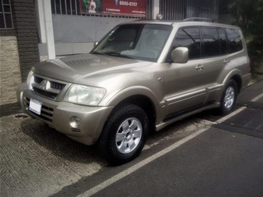

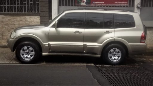

Where we landed: So ultimately, this is she. La Joya de la Montañas (the jewel of the mountains), 3.8 v6 limited, 70k mi and runs quiet AF. I couldn't find any gen2s with rear lockers or low miles and gen3 diesels were all over 10k. It was between this and another 03 Montero but this one had less miles, a quieter engine, and seemed like a down-to-earth purchase from a local guy instead of a pristinely detailed rig with a louder engine that was surely hiding its flaws.
