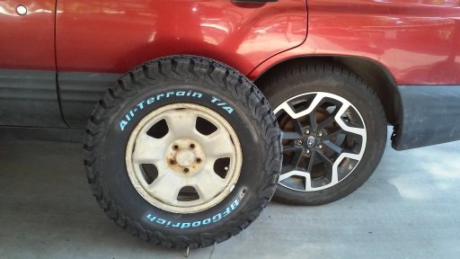

1. Tires- seems like 9/10 people here recommend the BFG A/T KO2's and i would be a fool to not try them. The geolanders also have my eyes as this set would replace my winter set of tires.

MarcosV1017
So I got new shoes, a face lift, a cool hat, and new contacts.

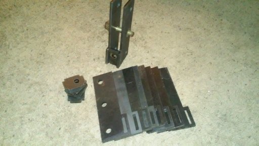

Also, the lower lift brackets were more work than I wanted to put in so I bought them from ADF. They have worked well.
No pics of the new headlights but they're LEDs because I got sick of replacing pigtails. Also built the awning thanks to the write up from @Amabob0.
