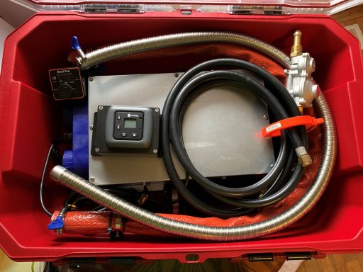

I have in operation the Propex HS2211 Heater. It uses propane and was not difficult to modify and install. Most of the work involved wiring.

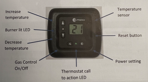

This model comes with a digital thermostat which keeps the tent at a constant temperature. This unit is also equipped with a countdown timer and is another function of the digital thermostat. What you can do is set the heater to come on automatically anywhere from 1-16 hours. The timer will start counting down and when it reaches zero, the heater will start and operate. I could see this being useful as a means of warming up the tent before going to bed if you're out hiking.
Although pricey, I feel very safe and don’t need another fuel source. I haven’t used it enough to provide an accurate assessment. I will provide more detail at a later date.
Highly encourage y’all to watch Rob’s video (Revere Overland) of this popular product: He was the spark for me to go this route and with his help, I’ve created my own heater. This parts list is based on this particular product being used in a roof top tent application.
Save the 75mm air outlet covers, I purchased most of these items from Amazon. I tried to use the exact wording so it will be easy to locate.
This project requires either the use of soldering equipment and/or crimp connection tools to add additional length to power supply and thermostat wiring.

This project isn’t a necessity and isn’t cheap. I was willing to spend the cash and time and I do believe it’s a much safer alternative for my particular roof top setup.
