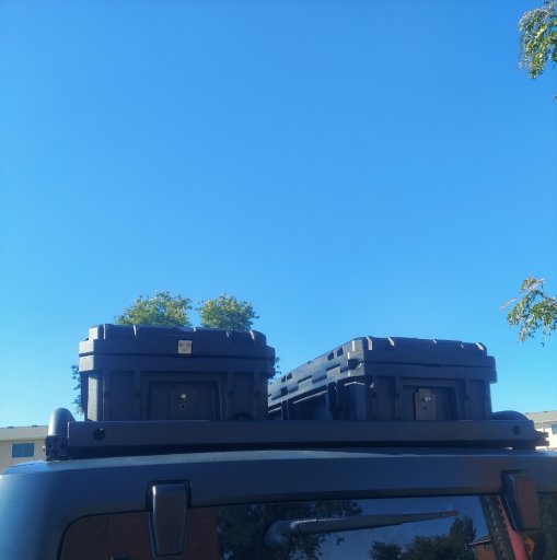

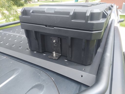

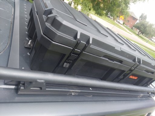

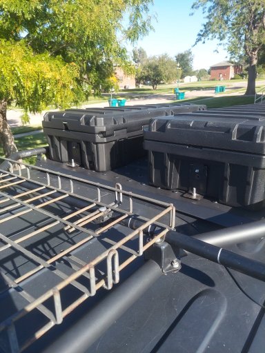

I just wanted to share a project I've been working on and help those who use the same roof rack system as I do, the 4 door LO-PRO mod rack from Adventure rack systems. I ended up buying 2 "L shaped" brackets and measured them and drilled holes into them to where I could bolt them together, as you can see in the picture. I then fished the bolt under the platform with a string (I didn't want to unatt9ach the system). I can only speak for the 95L, but I have two attached now and fit perfectly. You must make sure you attach the brack on the second farthest hole on both sides, or else the latches will not come out due to the bar. This is a cheaper alternative I came up with than buying a $400-$500 mount system.
**Update: I forgot to add pictures with both cases installed, which I will now add. So far, there is no movement from driving in high speeds or wind. I would recommend weatherproof the bolts and nuts to be on the safe side**
