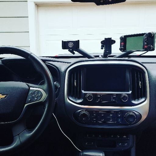

Hey, anyone have to 400xdr in 5th gen 4runner? looking for suggestions on mounting options.

I stopped by Ham Radio Outlet in Portland, OR and tried both radios before I bought mine. They're close enough in features that I didn't care too much, but I ended up liking the tactile feel of the keys on the Kenwood better. Here's how I have it mounted in my 4th gen 4Runner: Kenwood D710GA Mounting Solutions
