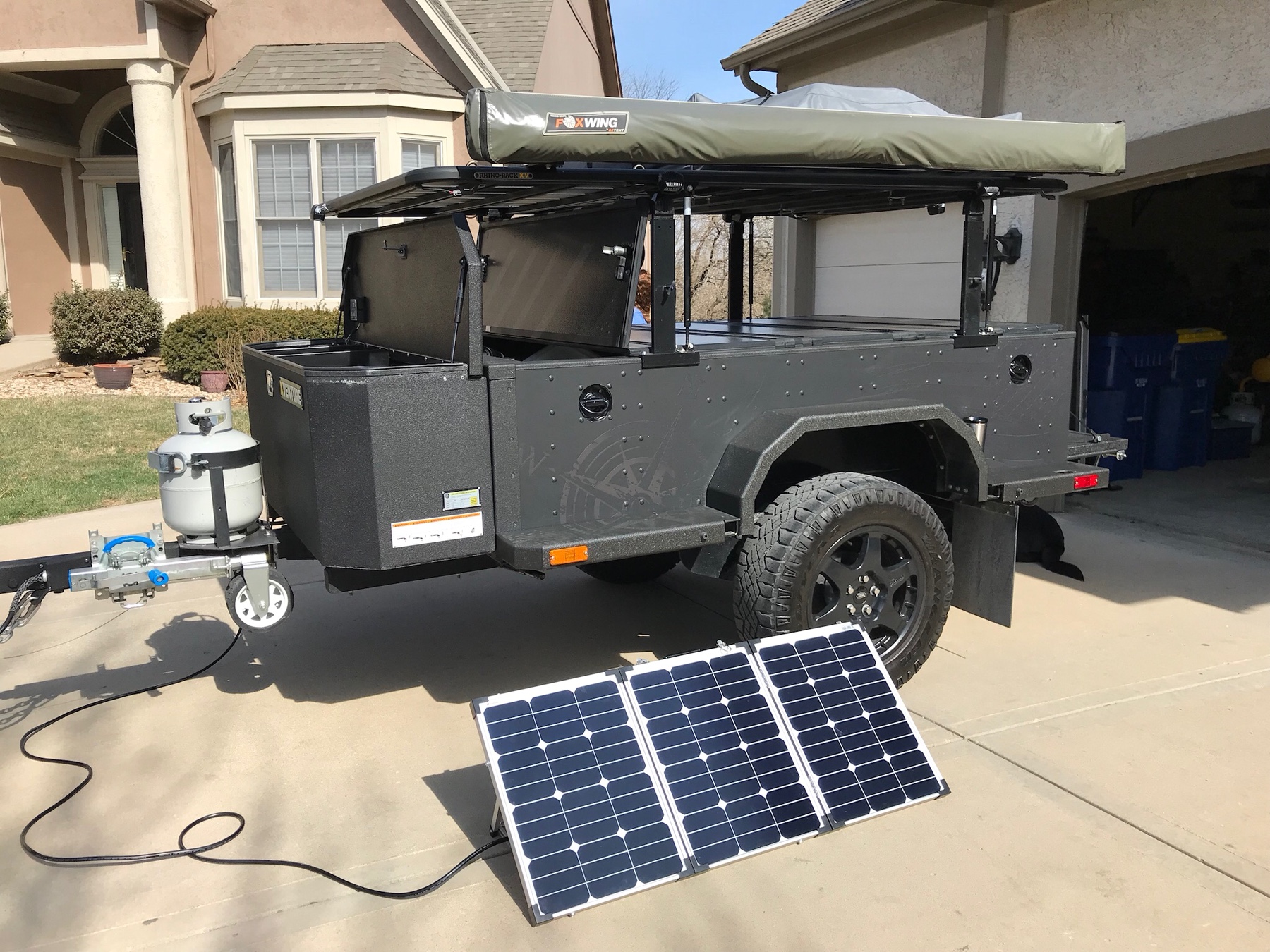

  • Purchase a solar panel for recharging the batteries

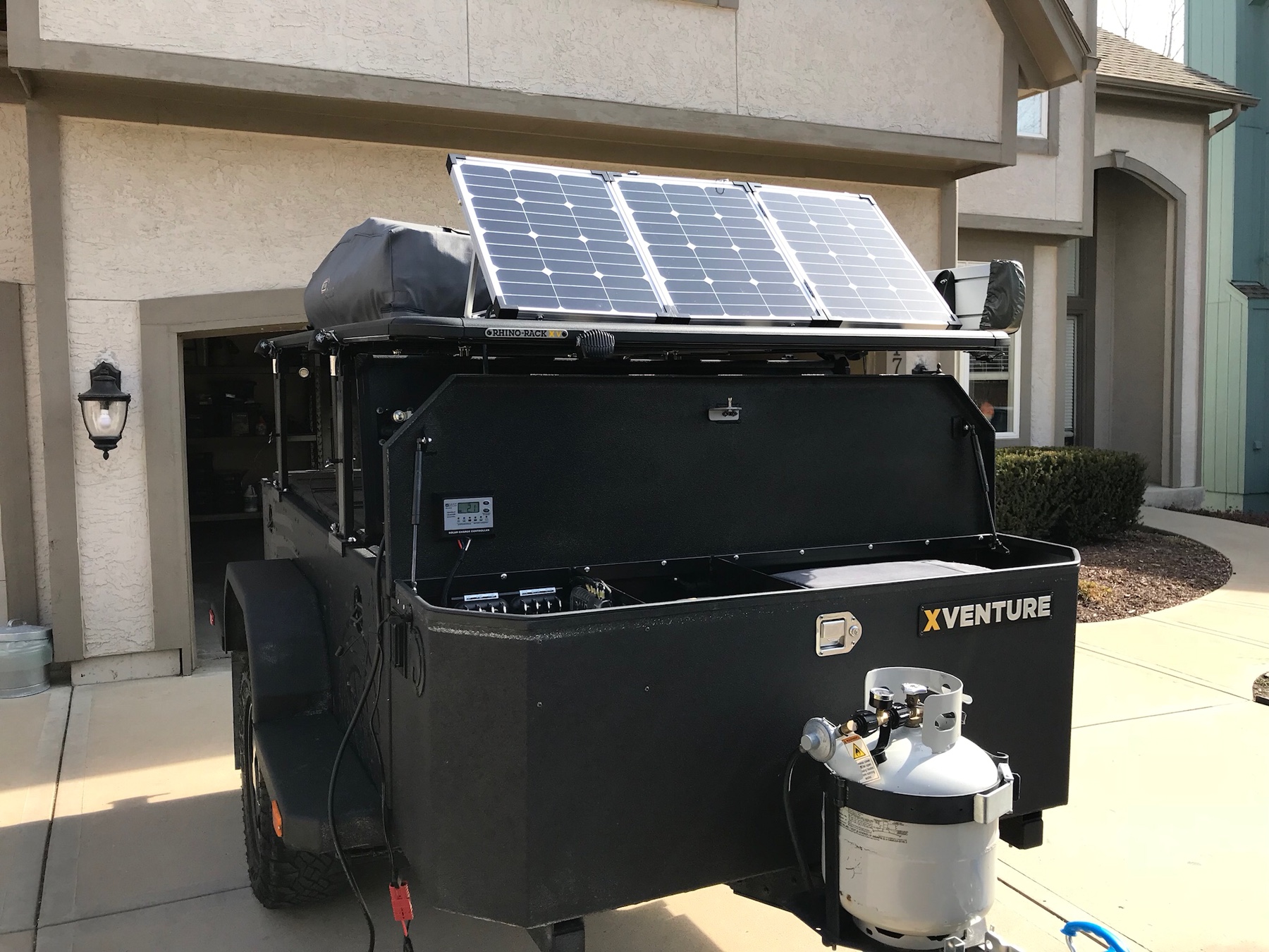

I've been waiting for a nice, sunny day to get the trailer prepped for future trips and play with some new toys. I'm really liking the Overland Solar 120 Watt folding panel! I also had a chance to setup my Trail Kitchens King Charles Chuck Box and Alu-Box pantry. The water tanks on the XV2 were winterized, so today was a good day to flush everything out and get the kitchen sink and shower working. Hours spent in the driveway prepping certainly pay dividends on the trail and in the campsite!

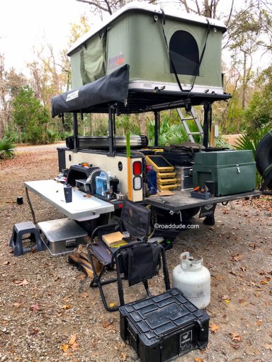

We recently used our XV2 trailer as a basecamp at SCARR2018 in Texas. 500 miles of highway and off-road driving was a dream with the XV2. Even though the loaded weight isn't anywhere close to 3,500 lbs, I use a brake controller in my Land Rover LR4. That makes a huge difference controlling stopping with the trailer. Here's some pictures from our setup:
Some of the gear shown here - REI Kingdom table and Solaire Everywhere grill. Jet Tent Pilot chairs from OzTent are phenomenal! The Solaire grill is infrared and makes quick work of grilling, even in windy conditions or bad weather.
ARB Simpson III with Annex. We use CCMultigear and OzTent sand mats. Yeti 65l cooler, Pelican case with most of my electronics, Alu-Box 60l for my pantry. Waste can on the left is trash and recycling on the right.
Sliding top utensil drawer on the Trail Kitchen King Charles Chuck Box. This thing is a lifesaver! Being able to pull a fork or knife out of a drawer just like you are at home was so nice! This was a big hit with my wife.

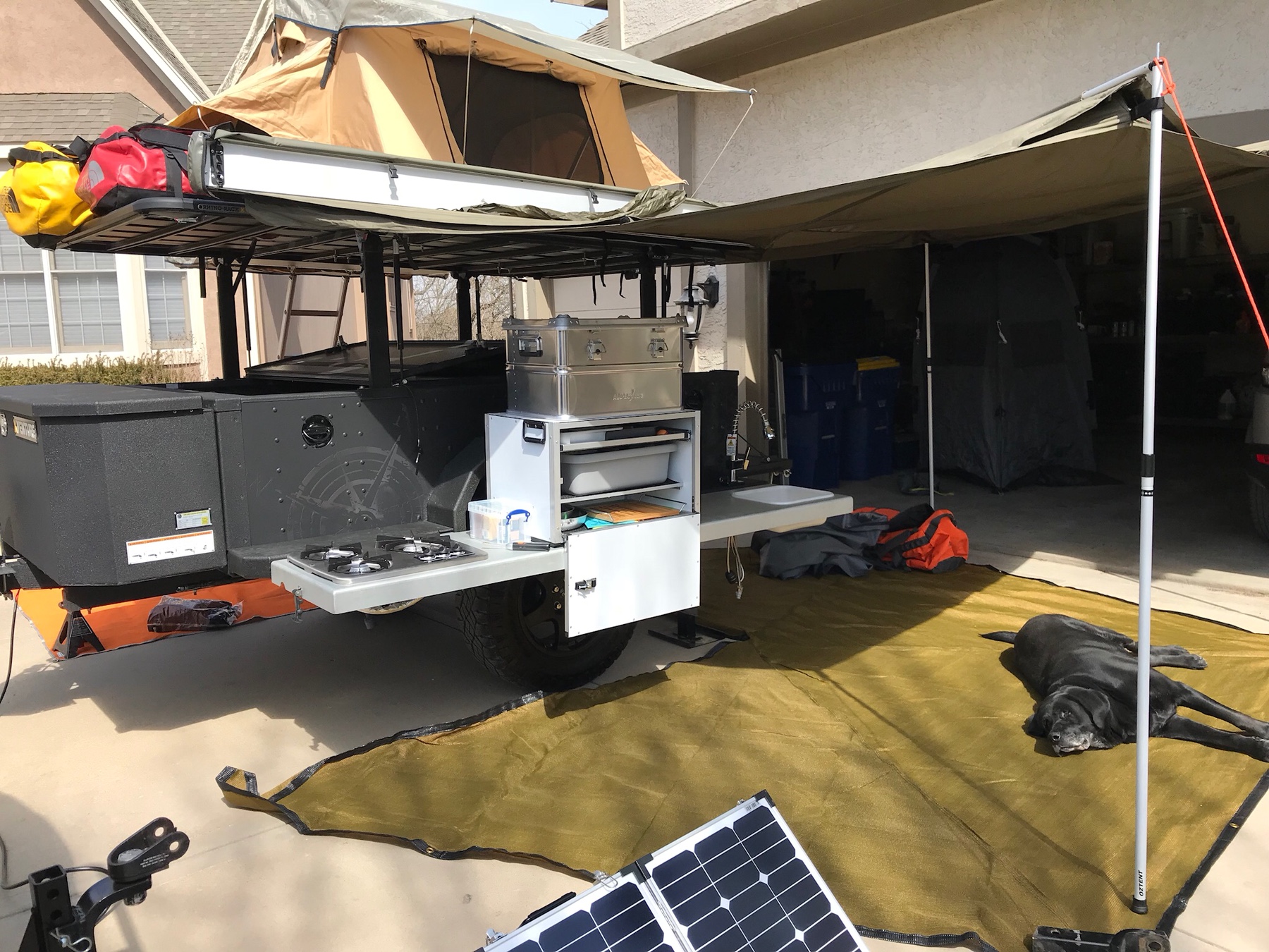

I finally got around to publishing a video I made on relocating the galley from the front of the trailer to the tailgate. I did a 2-week Overlanding trip solo and had to make a few modifications, since I normally have my wife there to help with setup/takedown. My first modification/upgrade was a hardshell RTT. I went with the Maggiolina Grand Tour. It was much easier to setup/takedown by myself compared to my ARB Simpson III. Next modification was moving the galley from where it was intended to ride in the front of the trailer to the tailgate. I had previously setup the galley by myself, but it was very time consuming and hard on me physically. Moving the galley to the tailgate means that it has to be unloaded first.
I quit using that front position for my counter almost immediately, being primarily a solo traveler. I keep my galley counter along the wheel well on one side, face of the counter protected from the rough bed liner with a 3/16" piece of ply. It's ended up being the best place for it, and with somewhere around 600 nights out now, the easiest and most efficient to grab from and stow back away.
I like your idea of keeping it on the tailgate, though too often camp for a quick night or pull over for a meal and don't set up the galley counter, but do use the tailgate for working on gear, etc.
Rush pack job going just down the road to another lake spot.
The long, solid, galley counter with hot and cold running water is one of the best things about this trailer, especially for extended stays, which I do a ton of. I use my counter as a desk, a work table, and kitchen counter, often all three within hours.
If I know I'm going ot be doing a lot of shooting with a lot of camera gear out, then doing a lot of computer work, or just want more counter space for big meal prep or whatever, I set up my kitchen box and stove at the end, not on the counter.
Otherwise the chuck box and stove almost always goes on the left end of the counter, which still leaves me a lot of free counter space between it and the sink.
