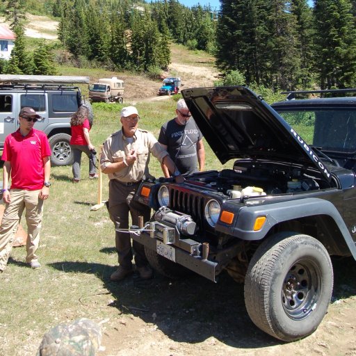

I can't remember the numbers but Warn does 3 things.
The M8000 is made in the USA,
The cheapest Warn is made in China.
And the one in the middle is manufactured in China, assmbled in the USA.
Not to say there is a difference in quality or performance or warranty or service life but 3 different lines for 3 different price points.
Me, I like the M8000 cuz it is old school.
At BC Overland in 2017, the Warn guy used my Jeep to show the differences between my old and his new Warn winch.
He never said one was better, they are just different.
Reactions: M Rose and 9Mike2

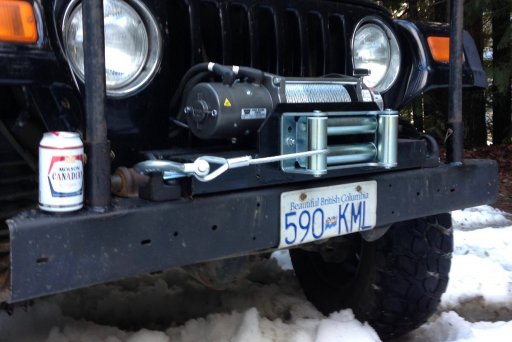

I run a Warn 15k. Worked fine for me for years. When i build bumpers for my rigs i fab in reciever hitchs front and rear. And wire in weatherproof quick connects. That way i can store my winch in the tool box out of the weather. Then decide if i want to front mount it or rear mount it. Depending what im doing. Being able to pull yourself out backwards is a nice option sometimes. Especially nice as insurance for water crossings or really steap decents. Sometimes pulling yourself forward just makes the problem worse and its just easier to pull yourself back out and pick a new line.
