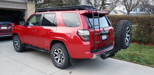

So guys... i bought the wilco hitchgate offset with the goal of carrying a second spare tire. (I want to drive the Dalton highway in AK, ive read having 2 spares is smart) I ran into a problem however... the spare under the 4runner prevents the hitchgate from sliding all the way into the hitch. Id rather not move the original spare from under the rig, as it would take up lots of interior space. My roof rack is already full as well. Has anyone else encountered this situation? What did you do to solve it? Im considering modifying the hitchgate, as i dont plan to tow from it.

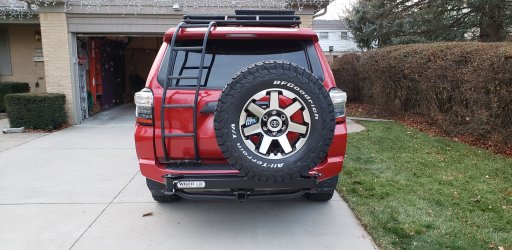

Heres what i did for now... and im going to test it a bit locally before i make the permanent decision. I kept the spare. Removed the extra wedgelock part (just unscrewed it, no cutting). Its removal bought me just enough clearance to get the hitchgate to the first hole in my receiver. I went to the hardware store and bought a heavy duty fully threaded stainless bolt. I put the bolt through the receiver and into the hitchgate. Inside the hitchgate (this was the hard part) i put a washer and one of those nuts with nylon? that doesnt spin. Then i threaded it though to the other side with my ratchet, and added another washer, locking washer, and nylon nut. When I tightened up the exterior nut and head of the bolt, it pushed the interior bolt sideways. This sandwiched the hitchgate up against the receiver nice and tight. Theres a small gap on the other side that im going to fill with some kind of wedge. I was able to stand and jump on the hitchgate with almost zero movement. The whole truck was moving but almost no budge on the hitchgate. Its not perfect, but its pretty darn good. My only concern is that any tiny movement will eventually turn into more over time... so i need to get the other side wedged just to make it a little better. 20191207_163428.jpg20191207_163419.jpg20191207_163317.jpg
