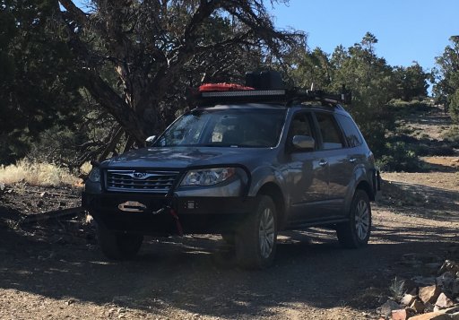

did u guys check out Silver canyon or Wyman canyon? cool side trips if u get around to it....cool vehicle.
Not this Trip. I intend to the next time I'm over in the area. I'm presently in the process of adding a 3 core radiator and an separate transmission cooler to my FOZ. She wasn't a happy camper.

Where did you get your bumpers from and your rock slides?
Those are too sweet.
What kind and how much lift?
What size of tires?
CenCalTacoma
490
Clovis, CA
3843
What size of tires?
1.) Had my For outfitted in Southern California at a shop called Leadfoot offroad.
a.) The bumpers and sliders add a lot of weight to the Foz. Akin to the Foz constantly towing a trailer. She will work a lot harder. Keep in mind she is a CAR & and not a Framed truck.
b.) Air flow is absolutely critical to the radiator and engine bay with a winch bumper.
I had to turn the AC off not to over heat climbing Westguard pass in 108 degree weather.
2.) I'm running an Anderson 2 inch lift in the front & 2 3/8 rear lift & rear diff drop and link. I also have new Struts and King Springs from Primitive Racing.
What size of tires?
3.) I'm running 225/65/17 or a 28.5 inch tire.
a.)Running larger tires changes the shift point on your Auto tranny & your speedometer will be off & don't forget the loss in MPG.

Do you mind if I ask how much on the bumpers and rock slides?
You're look at a $2000.00 a piece and the sliders came in at nearly 1000.00. That doesn't cover the winch the lights the wiring etc... Bottomline. Better be ready to break the bank, lol.
If you're just into lifting your FOZ and getting a larger tire on then I'd go with skid plates and a rear bumper for extra Gas and the ability to carry a full size spare. The front bumper is cool, but not necessarily needed. More of a look and a hell of a lot of money.

I have a 2" lift from Anderson, 215R 65 16's General AT2, full skid plate kit from Primitive Racing. Subaru roof rack (aka Yakama) with LED light bars front and rear, AX & Shovel holder, ARB awing.
Would like to run a full size spare, been looking at the Wilco spare tire carrier.
Does Leadfoot Off Road have these in stock?
CenCalTacoma
490
Clovis, CA
3843
They are a custom build. You'd need to ship your Foz to them. Fuji Heavy Industry makes too many changes not just form model year, but even during the same model year as they find better fab and suppliers for their uni body bumper mounts. Really weird but sadly the way it is. I talked with Josh a lot at Leadfoot for the low down when I was doing my build.

225/65 r17
Running a 2 inch lift
Some slight rubbing on the front fenders at the rock panel.
Solved with some cutting of the plastic wheel liner etc...
