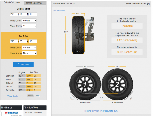

Website has handy tools for wheel offsets and getting a general idea where a new set of tires and wheels will end up
This is brilliant. Thank you.
