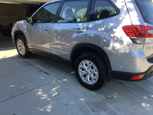

Two inch Ready Lift
Toyo open country 225/65/17 AT3s

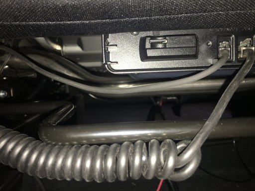

Under driver seat FTM 100 unit install

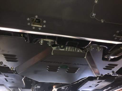

Front Primitive Racing skid plate/ tranny skid and rear diff cover.

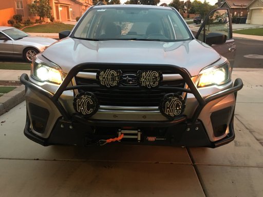

Warn wench bumper kit. Harbor freight ZXR 5000 wench
Stock bumper cut and fitted for warn bumper.

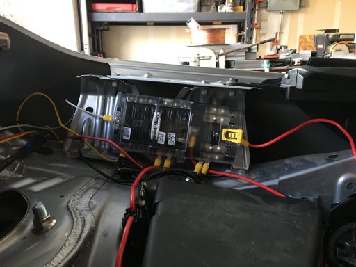

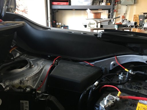

inner fender cover with fuse box
Wire fuse box for all auxiliary items.

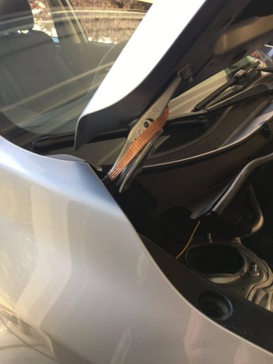

Full body Bonding for HF radio. hood both sides, all doors including both sides of rear hatch.

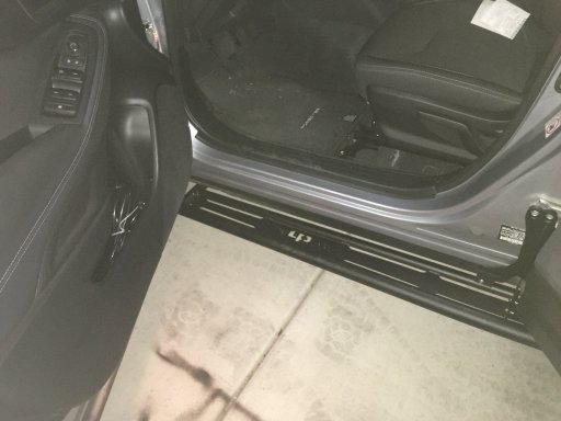

LP Adventure Rock Sliders
KC Pro Sport gravity Led G6 and KC Slimlite 6" led 50w spot beam.
And finally custom Brush Guard.

Two inch Ready Lift
