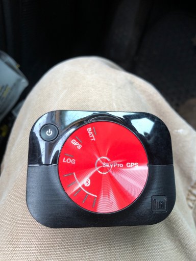

I thought I would confirm @Nickzero post. I run an iPad mini 4 in my Jeep with a dual electronics xgps160. The GPS receiver connects to my iPad through Bluetooth. I download certain areas on Gaia gps and can access them offline. The gps unit does a great job. My iPad is the WiFi only version. As long as you download the maps for your area, you won’t need WiFi access.
That GPS receiver has about a 10 hour battery life. But will run while plugged in. So it can basically run interrupted for as long as you have 12v of power
@Nickzero. It’s a sweet setup The receiver I have is great. It tracked me most recently through New Hampshire. Not as secluded as other parts of the country but there was a load of times that I had no cell service and no open path to the sky. With thick tree cover, it still worked flawlessly. Battery last long enough to explore all day. It connects with my iPad with hardly any hassle. And stays connected. The unit can connect to up to 5 devices too. I’d recommend it for sure
