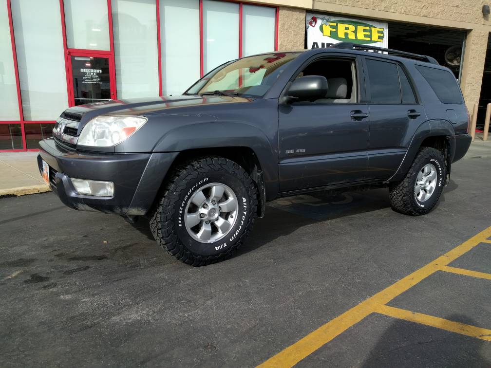

Well that was easier than I thought. A live chat with a BFG rep on their site yielded this info. I used your KO2 265/75/R16 as the example tire.
@80 PSI it would be 3415 lbs.
@40 PSI it would be 2100 lbs.
@35 PSI it would be 1910 lbs.
So it's not quite a linear dropoff rate ( where 40 PSI would be 1707.5 lbs.) and rather interesting to see some other numbers.
Thanks @Preston Tiegs! This has actually been on my mind for a while now and it's good to have an answer.
