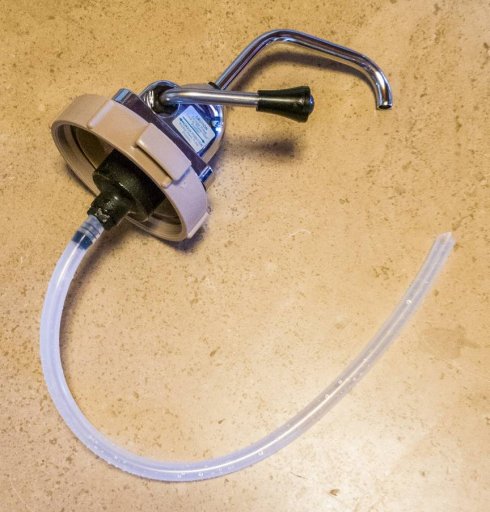

I live in the desert and remote camp so water use is a major concern. To limit water use but provide ease of use I installed a manual pump faucet in an extra sceptre can lid. This provides the perfect amount of water for my needs. Documented here: https://www.margygreen.com/Blog-Adventure/Sceptre-Water-Cansceptre%20water%20cans_15Sep2018_018.jpegsceptre%20water%20cans_15Sep2018_010.jpeg

$$$ how much
This pump faucett was ~ $30 on Amazon but you can vertical pump version on Amazon and eBay for ~$10. I have past experience with the one I used. You can use a sceptre can or aquatainer or any container with a lid to.mount the faucet to. It doesn't require a sealed system to work.

That's a way cool idea. Does pumping the faucet build up vacuum in the can? If so,does it have a built in vent or did you put a small hole in the original cap you used?
I think this is the only DIY or otherwise version I've seen that keeps the can upright. I like it!

No vacuum or pressurization of the jug is required. All pumping suction is with in the pump and hose (you can test the facuet pumping action just by holding the end of the hose in an open container of water. So the lid doesn't have to be cranked down tight.
BTW, this is the same faucet AT Overland includes with their trailer water tanks.

no, I mean does pumping water out of the jug create a vacuum (it should if it's not vented and if the lid *is* screwed down tight) That would limit the flow after a certain amount of time.
I ask because it's a known problem with some small RV water tanks that use a pump faucet vs. an electric pump (and even some with electric pumps). There are DIY fixes for the RV tanks, but the simplest for this would be put a small hole in the 'spare' plastic lid for the jerry can that has the pump in it...
Was hoping this particular manual pump faucet solved it altogether; it would be nice to not have to come up with potential leak prone DIY solutions if this faucet was used elsewhere.

I've never had that problem with tight lids on the jug or on my trailer.
