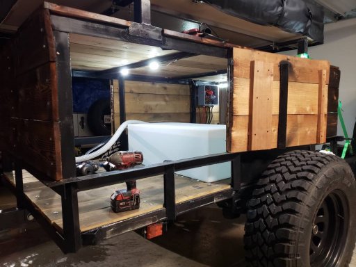

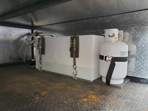

Am starting to design an off road trailer. Am considering installing a water tank and need some ideas. What did you use and where did you end up installing it?
I'm am running a 21 gallon tank and 12v on demand pump that runs off my deep cycle set up. Installed over the axle on the right side of trailer. Cargo and gear on the left side balance it out nice. 20190923_165548.jpeg20191018_081349.jpeg
