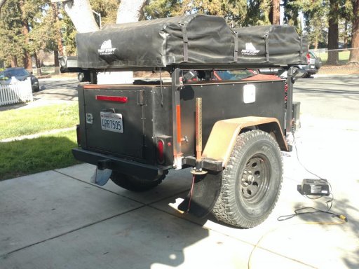

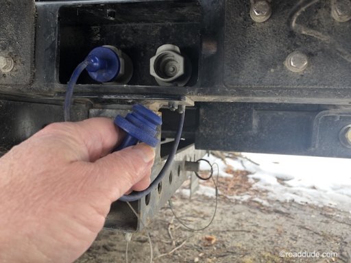

22 gal water tank here, under the trailer, above the axle, armored.
Tank is baffled to keep water from all sloshing to one side if off camber, maintaining center of gravity more than without.
- Fill spout cap is inside the trailer (forward of wheel well in image above); overflow tube comes out underneath the trailer there.
- On demand propane fired water heater in trailer rear of wheel well, armored from cargo.
- 12v pump adjacent to the water tank underneath, access plate through armor at rear.
- Easy to drain and winterize or sanitize, with central drain plug through armor.
- Water lines all mil spec pex style.
- Plumbed to front right with single line from water heater for shower hookup. Adjust temp/pressure at the heater.

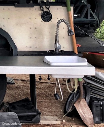

- Plumbed to left rear with separate hot/cold for faucet.
Water lines hook up with quick-release fittings, plugs when not using.
Faucet mounts through fender step.
Been a dream to have, especially when off-grid for long periods. Having hot and cold running water in camp changes the way I cook, clean, relax, and stay out longer.

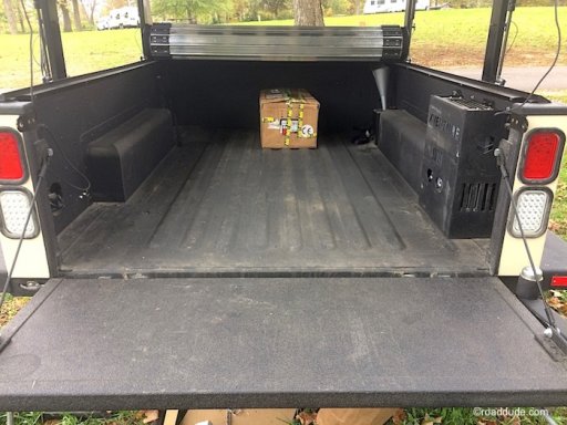

I have a 21gal tank and water pump on my M416 build. I keep it in the tub. Works well as long as temperatures are a over freezing.

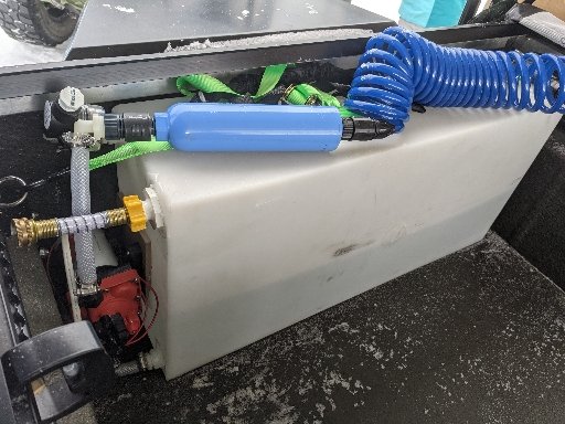

I have the same tank in my m416 (mine has a top on it) and insulated the tank with rigid foam and then put a 12v RV tank heating pad under it. Runs off the trailer batteries and keeps it from freezing at night.

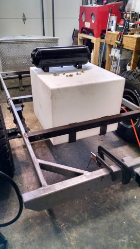

@Purpony are you still needing a tank? i used to design hydroponics and used tanks up to 300 gal and i used US Plastics who has a great selection. i have a 5x8 camp trailer with a 30 gal tank. that is a decent size that lasts the two of us for a few days. if you have the room, go with a 30 gal and you just dont have to fill it up all the way if you dont need to. might be nice to have the extra 10 gal versus a 20 gal tank. only thing i noticed is that my tank has a flange around it and that sits in between the frame members and when full, the bottom bows out a LOT. i took ratchet straps and made an X under the tank to give the bottom support. i'm sure it was designed to hold OK, but with bouncing and rough roads, i really wanted that bottom support. you will need a drain on the bottom, so i would find one with a drain port molded in at the bottom versus getting a drain kit and doing it yourself...doing it after is a better chance of leaking.
good luck with your build!
