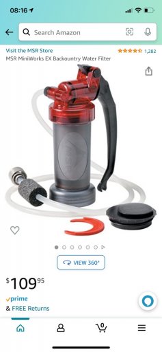

I have this one by MSR. Supposed to be good up to 1.5million gallons before a filter change is needed.
