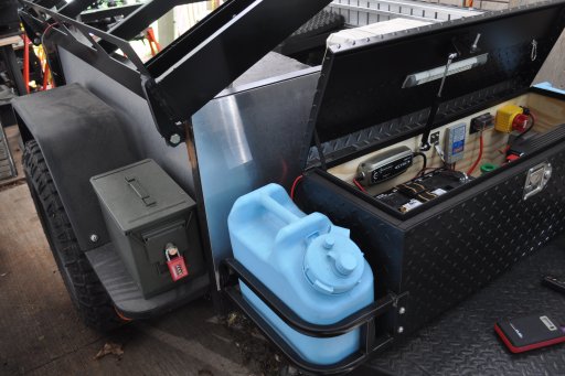

I bought a couple of spare lids for my Scepter water tanks, removed the small spout cap and replaced it with a variety of basically garden hose connectors and a angled brass fitting that's commonly used on RV's. I added a pick up tube to the cap and it sits on the bottom of the tank. At the end of the tube I attached a 12V aquarium tank pump that I can easily plug into my trailer power. I travel with the original cap on the tank and store the "pump" cap in my tongue box or the cargo area of my Jeep. I have 10 and 20 litre tanks (2 of each) and the modified cap fits on all of them. The water pressure is almost as good as what I have in my house!
