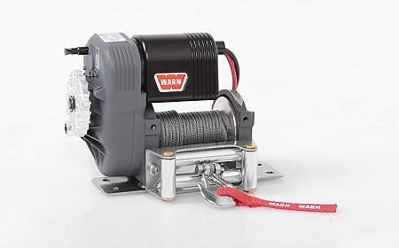

WARN 8274 winch. Who has one, What rig do you use it on, and why do you like it over newer model?

An old school winch that is a beast, and is underrated in strength. It's design, limits it's use in modern rigs (airbags), but for those that like a simpler, less electronically upscale vehicle, would you use this over cheaper more compact designs?93811

Two more pics with synthetic line on them938129381393814winch-mount for it.

That was the first winch I owned. In it's day, it pretty much held top spot unless you went to a commercial duty winch. With the new generation of motors and lower profile I prefer something modern and water proof in a 12k. If i'm not mistaken, Warn only rated that as an 8k. That was way under rated.
I will admit, I love the look.

That is what I read a long time ago. That this winch was WAY underrated to the point you had to be careful of the line rating, as the winch itself would just keep on pulling way past that 8 K rating.

I've seen that winch out pull the 10-12k ones in the same time frame. When I got rid of the Jeep that had mine, I got a12k, 2 speed commercial winch. Not quite as tall but 5 inch's wider. Nice thing was the spool held 200 foot of cable. On high speed it was rated at 1.2k. It would spool in about as fast as you walked. I would use it to move gear and people up hill sides when we were doing Adopt a Trail work.

I have one and it will eventually go on a FJ40 project. If it fit in my 80 series bumper I’d probably be running it now.
Faster, more rope, lots of upgrades out there.

I still uses mine I bought in 1997. They pull twice as fast when you put 24volts to it but only under a load. Have fun and Roll Tide.

Those winches have been around since the 50s. Warn actually bought the design rights form another company that went under. Currently they are the only winch Warn makes that is still made in Oregon, all the others are imported from China and just get a sticker on them and a huge mark up.
I was once part of a recovery where we used a single 8274 with all 100' of cable let out, pulling an 82 1 ton Suburban with a big block on 38s, hooked to a 75 1 ton K5 with a big block and 35s up a snow covered 12* grade. It was slow and the motor got so hot we started putting snow on it to cool as the brake wouldnt hold the load so we had to keep going. Thing pulled so many amps it melted the cables. It got the job done and is still in service to this day as far as I know on that Suburban.

That is quite the story about a 8275 chugging along, while in the middle of a melt down (Pun Intended). And it's still working years later, that is what legends are made from. I wonder if any of the newer models could come close to that type of use, and survive.
