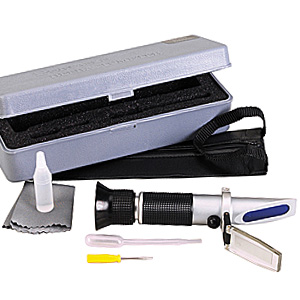

The last fluid at least that I can think of is the coolant. level is of course important but There is Electrolysis that occurs when fluid starts to break down and will start to eat away at the materials of you engine. You can use a voltmeter to measure voltage. A max of .4 volts is what you want to cap. anymore suggests that the corrosion inhibitors are pretty much gone. The use of a prestone gauge or better yet a refractometer to dial in your coolant to water ratio- I usually try to run distilled water when I flush systems as tap I have read shortens the lifespan of coolant. Coolant life is usually 3/5/10 though life can be shortened due to contamination . Also coolant color isnt what you should go by or generic all purpose coolant should be avoided . You have IAT / OAT / HOAT coolants a google search will explain these products. They are not be mixed as they will coagulate cause a bunch of clogging that wont be easy to fix

This is a Robinair refractometer. It is used to test antifreeze and battery fluid. It is a valuable tool that most would never think about but with aluminum components in most cars antifreeze can be very corrosive if not properly maintained. You should be checking it about every three months and along with the pH of the coolant. Most people pick up a hydrometer at the local auto store and call it good but they tend to be about 20 to 25 degrees off which could be a problem depending on where you are and plan on operating.

That's exactly what I used at work. Used something very similar for testing D.e.f. fluid too. It doesn't take anytime to test either.

I though I was the only one that used one of these, every time I get mine out to use it someone always says "what the hell is that"?

Haha, I use mine to test the specific gravity of my unfermented wort when brewing beer!
