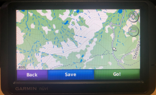

As i realize the limitations of my iphone gps (i love gaia but its offline maps are HUGE) i became interested in a dedicated gps unit. i see all these overland specific and trail ready devices like the Garmin overlander and the Magellan TR5/7 but they are overpriced and not in my budget. i remembered i used to have a Garmin from probably over ten years ago. i dug in my storage last time i was there and found it! After a fast google of how to update my old old old Garmin Nuvi 205W i saw this page which is FULL of topo maps that are routable. I wasn't sure if my ancient 205W would even work with this. nice surprise, it does, fantastically! the install is super easy. Download Garmin Basecamp, plug your gps unit into the pc, download the OSM Topo maps of your area, go to the folder you downloaded the OSM topo maps to and extract them, then run the batch file in the folder to put the maps in the garmin directory. go back to base camp and right click your gps unit in the left side margins, then import the maps of the areas you want.
this took me ten minutes including the dl and install of all the apps. seems like a bit of back and forth but its not that bad and saved me the money on a new gps.
Example of 2m:
Example of 800ft:
