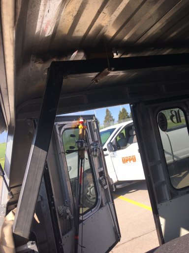

This is what I came up with had the rack on the truck for years came across the topper on Craiglist for $100 figured I would give it try rack is supported by the four legs bolted thru the topper sealed with plumbers putty it made to give and stay sealed

Nice build on the homemade cap. That Rack will hold enough supplies for a small army.

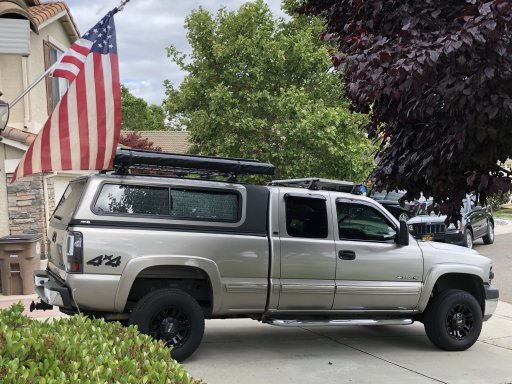

I have an ARE Overland Series. Looking at a RTT this Summer. Holds 250lbs. Their commercial line holds 500lbs from what I read.
I ordered mine with the carpet liner, double LED strip lights, and roof rack rails for Yakima cross bars. 2755D642-EF4B-40F8-8FDB-9F92C37C2832.jpegD3E32C06-9D5C-4DA6-B486-2E1E33C0C028.jpeg
