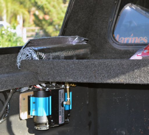

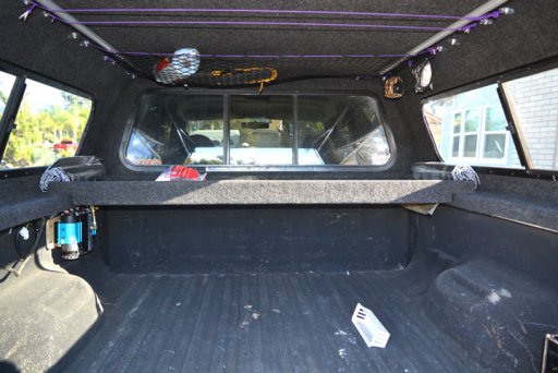

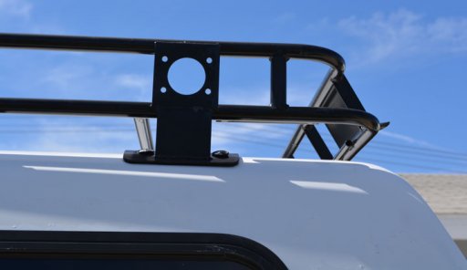

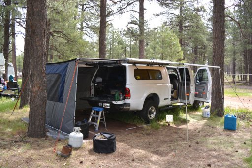

We use a Cap/Shell on our 99 F-250 Short bed and we love it. Wife and I sleep in it and haul things for the house, yard and racing in it as well as use it for camping/overlanding.
I made my own rack to suit our needs and to mount awnings for shade. Still have a lot of things to add but we are getting closer to having it done.. Yah right .. LOL

The biggest issue by far that we have had to deal with is Dust! It comes in around the tail gate and through all the voids in the bed where the inner bed sheet metal is not fitted completely to the outer skin.

I do believe that the construction of the cap and the rack are both important. Our cap is a 12 year old model and the company has gone out of business so no way to call and ask them about it. It has a 5/8" or so thicker top section over 3 feet wide running the full length of the top, not sure if it is intended for rack mounting?
But the PO had installed a rack by drilling holes along the center of the radius where the top curves down to become the sides. I tried to fashion plates to match this radius 6" long and 2.5" wide to make use of some of these holes. I used three per side two bolts each to bolt them to the cap and then tacked the "legs" of the assembled rack to the plates.
Point is that if the weight is spread out on the cap at the caps strength points or area you should be ok. But buying a simple two rail mounting system with four points of contact on the top/roof, I would worry about that. The more mounting points for the rack to the cap the less weight each point has on it. So I would get or build a rack that has 6 to 8 points of contact each being 4"x2" in surface size to spread the load out on the fiberglass or plastic, if I were you.
I walk around on the roof of ours - so 220 lbs or so on a 13"long x 4" wide footprint going to an even smaller area as I lift my heel stepping has not harmed the roof yet.
