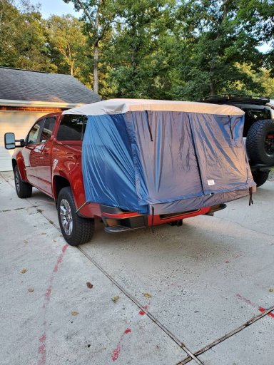

Well we have our JK all built up and it's a great setup for one man excursions but my wife usually goes and we we pull a little Intech Pursue camper trailer so I decided to go with a diesel Colorado this time around. The JK pulls it well around here but it really had to scream to get up the mountains in western VA. Having had a Cummins Ram as my last tow rig I really prefer how the diesel pulls.

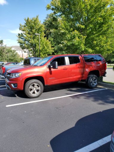

I picked up this 2016 Z71 on Saturday with 35k on the clock so it should be a good rig for a while. Lately I've been on a year or less turnover rate so I need to get this one right this time so the wife doesn't kill me.
The plans so far are somewhere around 2-3" of lift and 32-33" Falken AT3Ws. The shell has it sitting almost level as it is so I'll have to piece together a good combo of lift to stay away from the Carolina Squat look.

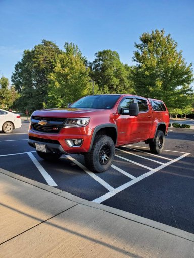

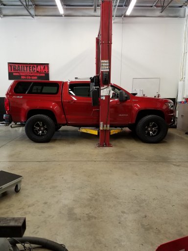

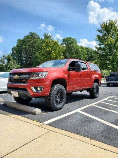

Specs so far:
Suspension:
Front - Rancho RS7000 QuickLift 1.75" with a 1.25" leveling kit on top for 3" (ish) total. ReadyLift UCA, dif drop and swaybar relocation
Rear - ReadyLift 1.5" universal Add A Leaf with a 1" block - actual gain about 3.25" - Rancho RS7000 Silverado spec shocks for a little more travel than stock
Timbren SES bumpstop helper springs
Wheels & Tires:
Fuel Recoil 17 x 8.5, +7mm offset, satin black
Falken Wildpeak AT3W 275/70R17 C-rated
Armor & Protection:

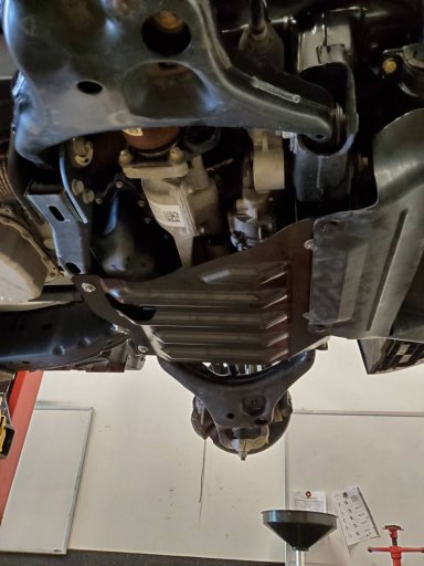

AEV Engine Skid Plate
Factory Z71 flares
Misc:
Removed front air dam for clearance
Tow mirrors were there when purchased. Still deciding if they stay or not.
