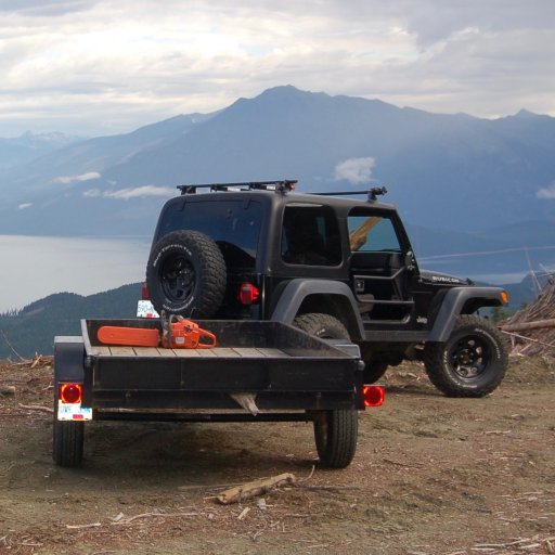

Forget the generic bolt together Lowes, Harbour Freight style. Go to a trailer manufacturer, retail sales outlet and get a welded fully built trailer. I started with a Mirage I used for work. And specced it with a 3500# axle and 15" wheels. With 100K work miles on it it is still like new. All I did was an axle flip.
This is a 5x10, they make a 4x6 too,
